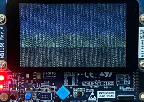

I've got a problem with displaying an image classification AI on my board. So far I've been following this tutorial:
https://wiki.st.com/stm32mcu/wiki/AI:How_to_use_Teachable_Machine_to_create_an_image_classification_application_on_STM32
starting from step 3, as I already have a trained AI model as .tflite file.
The execution with the .yaml file is working fine, it's flashing but the display is only showing artifacts.
Hardware details:
STM32H747I-DISCO: MB1248-H747I-D03
- LCD Daughterboard: MB1166-A09
- Panel Controller: NT35510
B-CAMS-OMV:
Camera module adapter board: MB1683-CAMS-A02
- Camera module:  MB1379-2V8-A05
- Image sensor: OV5640
The display was a newer version so I changed the defines in
application_code/image_classification/STM32H7/Application/STM32H747I-DISCO/Inc/CM7/stm32h747i_discovery_conf.h
to this:
#define USE_LCD_CTRL_OTM8009A             0U
#define USE_LCD_CTRL_NT35510                1U
#define USE_LCD_CTRL_ADV7533                0U
The nt35510.c and .h files already existed in the Drivers/BSP/Components folder. I don’t know how to proceed from this, the AI model and flashing seems to work just fine, I think it’s a hardware/driver issue with the LCD? Any help on what to do is appreciated.
I know that the tutorial I followed was last updated a year ago, but there are several deprecated tutorials out there and the ModelZoo is also getting updated every now and then, if there are any more recent options on how to do this, please let me know as well. Thanks!

Hi ​@Chris44,
This tutorial is indeed a bit old.
I would suggest using the STM32 Model Zoo services.
Please look at this tutorial:
stm32ai-modelzoo/image_classification/mobilenetv2 at main · STMicroelectronics/stm32ai-modelzoo
I would suggest looking for a model recommended for the H7, for example:
Have a good day,
Julian
