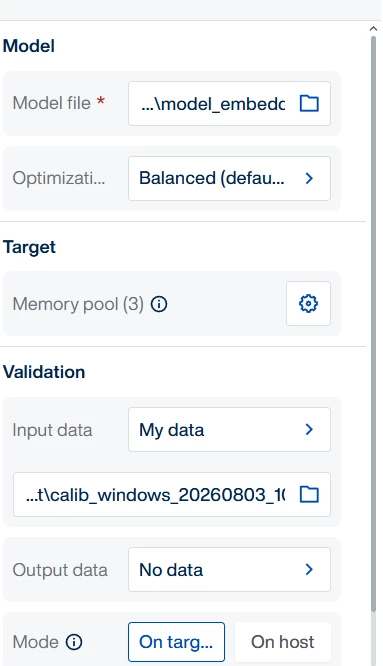

Trouble at generationg code with my .onnx model
In file included from Middlewares/ST/AI/Misc/Src/ai_device_adaptor.c:19:
Middlewares/ST/AI/Misc/Inc/ai_device_adaptor.h:655:8: error: unknown type name 'UART_HandleTypeDef'; did you mean 'DMA_HandleTypeDef'?
  655 | extern UART_HandleTypeDef UartHandle;
      |        DMA_HandleTypeDef
Middlewares/ST/AI/Misc/Inc/ai_device_adaptor.h: In function 'port_io_get':
Middlewares/ST/AI/Misc/Inc/ai_device_adaptor.h:664:12: error: implicit declaration of function 'HAL_UART_Receive' [-Wimplicit-function-declaration]
  664 |   status = HAL_UART_Receive(&UartHandle, (uint8_t *)c, 1, timeout);
Middlewares/ST/AI/Misc/Inc/ai_device_adaptor.h: In function 'port_io_write':
Middlewares/ST/AI/Misc/Inc/ai_device_adaptor.h:676:12: error: implicit declaration of function 'HAL_UART_Transmit' [-Wimplicit-function-declaration]
  676 |   status = HAL_UART_Transmit(&UartHandle, buff, count, HAL_MAX_DELAY);
make: *** [Makefile:188: build/ai_device_adaptor.o] Error 1

EsmanurJKBest answer
Aug 7, 2026 1:02 PM UTC
I solved the problem bu using X CUbe-AI package on Cube Mx.
Thanks for attention.

Julian E.
Aug 7, 2026 12:51 PM UTC
HI ​@EsmanurJK,
Could you please provide more context on what you are doing?
Which board are you using?
These are the logs when you click Run I suppose?
Have a good day,
Julian
​In order to give better visibility on the answered topics, please click on 'Accept as Solution' on the reply which solved your issue or answered your question.
EsmanurJKAuthorBest answer
Esmanur
Julian E.
Aug 10, 2026 7:10 AM UTC
Hi  ​@EsmanurJK,
I’m glad you solved your issue.
For X Cube AI, this is not recommended to use it as it is deprecated.
We now have a new tool called STM32CubeAI Studio: STM32Cube AI Studio- The next-gen stand-alone tool for embedded AI - STMicroelectronics
This is simpler to use and should help you avoid potential issues that you may encounter with X Cube AI
Have a good day,
Julian
