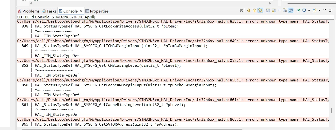

Transplant STM32N6 Model Zoo AI camera code into Touchgfx project
I have been using STM32N6 to conduct model training and deployment for the model zoo. Now, I want to transfer the generated code to my TouchGFX project for embedded use in the CubeIDE environment. However, when I am transferring several files, before the transfer, the original files did not have this error, but after the transfer, there is this error and it is particularly common, mostly for the official-generated code. As follows:
  When these files are transferred:
After the transplantation was completed, an error occurred:
./../../Drivers/STM32N6xx_HAL_Driver/Inc/stm32n6xx_hal.h:893:1: error: unknown type name 'HAL_StatusTypeDef'; did you mean 'HAL_TIM_StateTypeDef'?
893 | HAL_StatusTypeDef HAL_SYSCFG_GetWriteQosNP1(uint32_t *pQosValue);
../../../Drivers/STM32N6xx_HAL_Driver/Inc/stm32n6xx_hal.h:895:1: error: unknown type name 'HAL_StatusTypeDef'; did you mean 'HAL_TIM_StateTypeDef'?
895 | HAL_StatusTypeDef HAL_SYSCFG_GetReadQosNP1(uint32_t *pQosValue);
../../../Drivers/STM32N6xx_HAL_Driver/Inc/stm32n6xx_hal.h:898:1: error: unknown type name 'HAL_StatusTypeDef'; did you mean 'HAL_TIM_StateTypeDef'?
898 | HAL_StatusTypeDef HAL_SYSCFG_GetWriteQosNP2(uint32_t *pQosValue);
../../../Drivers/STM32N6xx_HAL_Driver/Inc/stm32n6xx_hal.h:900:1: error: unknown type name 'HAL_StatusTypeDef'; did you mean 'HAL_TIM_StateTypeDef'?
900 | HAL_StatusTypeDef HAL_SYSCFG_GetReadQosNP2(uint32_t *pQosValue);
../../../Drivers/STM32N6xx_HAL_Driver/Inc/stm32n6xx_hal.h:903:1: error: unknown type name 'HAL_StatusTypeDef'; did you mean 'HAL_TIM_StateTypeDef'?
903 | HAL_StatusTypeDef HAL_SYSCFG_GetwriteQosCPUSS(uint32_t *pQosValue);
../../../Drivers/STM32N6xx_HAL_Driver/Inc/stm32n6xx_hal.h:905:1: error: unknown type name 'HAL_StatusTypeDef'; did you mean 'HAL_TIM_StateTypeDef'?
905 | HAL_StatusTypeDef HAL_SYSCFG_GetReadQosCPUSS(uint32_t *pQosValue);
../../../Drivers/STM32N6xx_HAL_Driver/Inc/stm32n6xx_hal.h:934:1: error: unknown type name 'HAL_StatusTypeDef'; did you mean 'HAL_TIM_StateTypeDef'?
934 | HAL_StatusTypeDef HAL_SYSCFG_ConfigVDDIOCompensationCell(uint32_t Selection, uint32_t Code,
../../../Drivers/STM32N6xx_HAL_Driver/Inc/stm32n6xx_hal.h:937:1: error: unknown type name 'HAL_StatusTypeDef'; did you mean 'HAL_TIM_StateTypeDef'?
937 | HAL_StatusTypeDef HAL_SYSCFG_GetVDDIOCompensationCell(uint32_t Selection, const uint32_t *pCode, uint32_t *pNmosValue,
../../../Drivers/STM32N6xx_HAL_Driver/Inc/stm32n6xx_hal.h:946:1: error: unknown type name 'HAL_StatusTypeDef'; did you mean 'HAL_TIM_StateTypeDef'?
946 | HAL_StatusTypeDef HAL_SYSCFG_ConfigVDDCompensationCell(uint32_t Code, uint32_t NmosValue, uint32_t PmosValue);
../../../Drivers/STM32N6xx_HAL_Driver/Inc/stm32n6xx_hal.h:951:1: error: unknown type name 'HAL_StatusTypeDef'; did you mean 'HAL_TIM_StateTypeDef'?
951 | HAL_StatusTypeDef HAL_SYSCFG_GetVDDCompensationCell(uint32_t Code, uint32_t *pNmosValue,
In file included from C:/Users/dell/Desktop/N6/n6_touchgfx/n6_cs/STM32CubeIDE/Appli/AI_bsp/Camera_Middleware/inc/cmw_camera_conf.h:33,
from C:/Users/dell/Desktop/N6/n6_touchgfx/n6_cs/STM32CubeIDE/Appli/AI_bsp/Camera_Middleware/inc/cmw_camera.h:29,
from C:/Users/dell/Desktop/N6/n6_touchgfx/n6_cs/STM32CubeIDE/Appli/AI_bsp/Camera_Middleware/inc/cmw_utils.h:23:
C:/Users/dell/Desktop/N6/n6_touchgfx/n6_cs/STM32CubeIDE/Appli/AI_bsp/Camera_Middleware/STM32N6570-DK/inc/stm32n6570_discovery_bus.h:28:10: fatal error: stm32n6570_discovery_conf.h: No such file or directory
28 | #include "stm32n6570_discovery_conf.h"
compilation terminated.
make[1]: *** [AI_bsp/Camera_Middleware/src/subdir.mk:25: AI_bsp/Camera_Middleware/src/cmw_utils.o] Error 1
make: *** [makefile:101: all] Error 2
"make -j20 all" terminated with exit code 2. Build might be incomplete.
14:29:56 Build Failed. 467 errors, 8 warnings. (took 22s.603ms)
And there are over four hundred such error reports scattered across multiple folders.
Looking forward to the answers from the experts.

dianzijunAuthor
Jun 6, 2025 6:49 AM UTC
My problem has not been solved yet.Several files in the compilation project report the error "unknown type name 'HAL_StatusTypeDef'". When pressing F3, the definition can be seen. Redefining it in other .h files results in a duplicate definition error. I don't know what the reason is?Could you please show me? I'm really confused right now.
C:/Users/dell/Desktop/n6touchgfx/MyApplication/Drivers/STM32N6xx_HAL_Driver/Inc/stm32n6xx_hal.h:880:1: error: unknown type name 'HAL_StatusTypeDef'; did you mean 'HAL_TIM_StateTypeDef'?
880 | HAL_StatusTypeDef HAL_SYSCFG_ReEnableWritePostingErrorCapture(void);
C:/Users/dell/Desktop/n6touchgfx/MyApplication/Drivers/STM32N6xx_HAL_Driver/Inc/stm32n6xx_hal.h:892:1: error: unknown type name 'HAL_StatusTypeDef'; did you mean 'HAL_TIM_StateTypeDef'?
892 | HAL_StatusTypeDef HAL_SYSCFG_GetWriteQosNP1(uint32_t *pQosValue);
C:/Users/dell/Desktop/n6touchgfx/MyApplication/Drivers/STM32N6xx_HAL_Driver/Inc/stm32n6xx_hal.h:894:1: error: unknown type name 'HAL_StatusTypeDef'; did you mean 'HAL_TIM_StateTypeDef'?
894 | HAL_StatusTypeDef HAL_SYSCFG_GetReadQosNP1(uint32_t *pQosValue);
C:/Users/dell/Desktop/n6touchgfx/MyApplication/Drivers/STM32N6xx_HAL_Driver/Inc/stm32n6xx_hal.h:897:1: error: unknown type name 'HAL_StatusTypeDef'; did you mean 'HAL_TIM_StateTypeDef'?
897 | HAL_StatusTypeDef HAL_SYSCFG_GetWriteQosNP2(uint32_t *pQosValue);
C:/Users/dell/Desktop/n6touchgfx/MyApplication/Drivers/STM32N6xx_HAL_Driver/Inc/stm32n6xx_hal.h:899:1: error: unknown type name 'HAL_StatusTypeDef'; did you mean 'HAL_TIM_StateTypeDef'?
899 | HAL_StatusTypeDef HAL_SYSCFG_GetReadQosNP2(uint32_t *pQosValue);
C:/Users/dell/Desktop/n6touchgfx/MyApplication/Drivers/STM32N6xx_HAL_Driver/Inc/stm32n6xx_hal.h:902:1: error: unknown type name 'HAL_StatusTypeDef'; did you mean 'HAL_TIM_StateTypeDef'?
902 | HAL_StatusTypeDef HAL_SYSCFG_GetwriteQosCPUSS(uint32_t *pQosValue);
C:/Users/dell/Desktop/n6touchgfx/MyApplication/Drivers/STM32N6xx_HAL_Driver/Inc/stm32n6xx_hal.h:904:1: error: unknown type name 'HAL_StatusTypeDef'; did you mean 'HAL_TIM_StateTypeDef'?
904 | HAL_StatusTypeDef HAL_SYSCFG_GetReadQosCPUSS(uint32_t *pQosValue);
C:/Users/dell/Desktop/n6touchgfx/MyApplication/Drivers/STM32N6xx_HAL_Driver/Inc/stm32n6xx_hal.h:933:1: error: unknown type name 'HAL_StatusTypeDef'; did you mean 'HAL_TIM_StateTypeDef'?
933 | HAL_StatusTypeDef HAL_SYSCFG_ConfigVDDIOCompensationCell(uint32_t Selection, uint32_t Code,
C:/Users/dell/Desktop/n6touchgfx/MyApplication/Drivers/STM32N6xx_HAL_Driver/Inc/stm32n6xx_hal.h:936:1: error: unknown type name 'HAL_StatusTypeDef'; did you mean 'HAL_TIM_StateTypeDef'?
936 | HAL_StatusTypeDef HAL_SYSCFG_GetVDDIOCompensationCell(uint32_t Selection, const uint32_t *pCode, uint32_t *pNmosValue,
C:/Users/dell/Desktop/n6touchgfx/MyApplication/Drivers/STM32N6xx_HAL_Driver/Inc/stm32n6xx_hal.h:945:1: error: unknown type name 'HAL_StatusTypeDef'; did you mean 'HAL_TIM_StateTypeDef'?
945 | HAL_StatusTypeDef HAL_SYSCFG_ConfigVDDCompensationCell(uint32_t Code, uint32_t NmosValue, uint32_t PmosValue);
C:/Users/dell/Desktop/n6touchgfx/MyApplication/Drivers/STM32N6xx_HAL_Driver/Inc/stm32n6xx_hal.h:950:1: error: unknown type name 'HAL_StatusTypeDef'; did you mean 'HAL_TIM_StateTypeDef'?
950 | HAL_StatusTypeDef HAL_SYSCFG_GetVDDCompensationCell(uint32_t Code, uint32_t *pNmosValue,
make[1]: *** [STM32Cube_FW_N6/Drivers/BSP/STM32N6570-DK/src/subdir.mk:31: STM32Cube_FW_N6/Drivers/BSP/STM32N6570-DK/src/stm32n6570_discovery.o] Error 1
make: *** [makefile:115: all] Error 2
14:21:53 Build Failed. 523 errors, 11 warnings. (took 24s.913ms)
