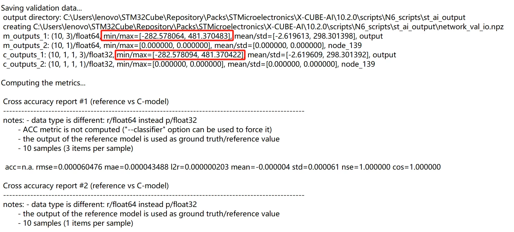

I have validate on the STM32N6 board by onnx model in STM32MX,but i have two different output ,like this:
 m_outputs_1: (10, 3)/float64, min/max=[-282.578064, 481.370483], mean/std=[-2.619613, 298.301398], output  m_outputs_2: (10, 1)/float64, min/max=[0.000000, 0.000000], mean/std=[0.000000, 0.000000], node_139  c_outputs_1: (10, 1, 1, 3)/float32, min/max=[-4.547175, 5.813805], mean/std=[0.008044, 4.321293], output  c_outputs_2: (10, 1, 1, 1)/float32, min/max=[0.000800, 0.000800], mean/std=[0.000800, 0.000000], node_139
the  m_outputs_1 is error, and c_outputs_1 is correct,why? what can lead to this problem?
please help me ,thanks very much!!!
I have upload the report.txt and onnx model in the attach.

Here is an example of report I get, which is correct:
Saving validation data...
 output directory: C:\ST\STEdgeAI\2.2\scripts\N6_scripts\st_ai_output
 creating C:\ST\STEdgeAI\2.2\scripts\N6_scripts\st_ai_output\network_val_io.npz
 c_outputs_1: (10, 1, 1, 3)/float32, min/max=[-282.578094, 481.370422], mean/std=[-2.619609, 298.301392], output
 c_outputs_2: (10, 1, 1, 1)/float32, min/max=[0.000000, 0.000000], mean/std=[0.000000, 0.000000], node_139
Computing the metrics...
 Cross accuracy report #1 (reference vs C-model)
 notes: - data type is different: r/float64 instead p/float32
 - ACC metric is not computed ("--classifier" option can be used to force it)
 - the output of the reference model is used as ground truth/reference value
 - 10 samples (3 items per sample)
 acc=n.a. rmse=0.000060476 mae=0.000043488 l2r=0.000000203 mean=-0.000004 std=0.000061 nse=1.000000 cos=1.000000

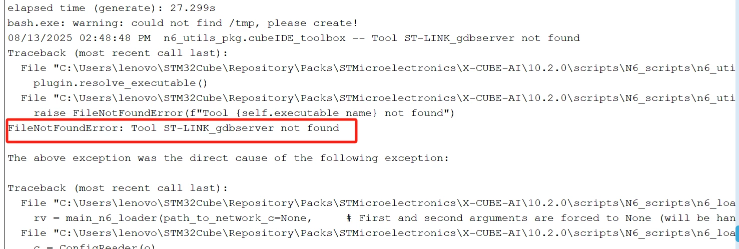

Hello
Can you paste the end of the traceback in your screenshot above ? please?
(i.e. the above exception was the direct cause .... up to the end ?)
+ if this does not help (i.e. if the cubeide path mentionned here is the one your are expecting), you can raise the verbosity of scripts by setting .setLevel(logging.DEBUG) in both n6_utils_pkg/config_reader.py (line 14) oand n6_utils_pkg/cubeIDE_toolbox.py (line 15), this will help find the issue.
Possible fix is to remove your  "cubeide_path": "E:/ST/STM32CubeIDE_1.18.1/STM32CubeIDE", line from the config file and see if it works better. (though it would be better to understand what's not good about your config here..)

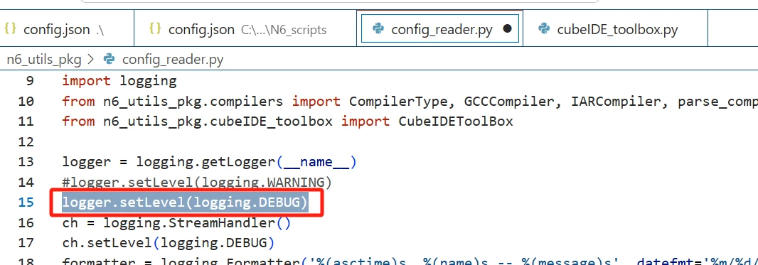

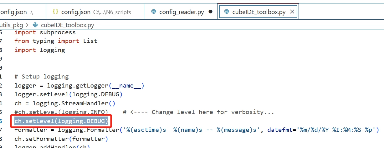

cxfAuthor
Aug 11, 2025 2:07 AM UTC
Hi @SlothGrill
Thank you for your help very much!
Now, i have follow your advice ,and modify the two py like this:
and the cubeide_path has been set to "",when I run the n6_loader.py, result can be get in the attach.
please help me thanks !
SlothGrill
Aug 11, 2025 8:32 AM UTC
hello
Thanks for the log could you further help to find what is going on:
  • In a shell, if you go to `...\X-CUBE-AI\10.2.0\scripts\N6_scripts` , what is the output of `which stm32cubeide` ?
  • Based on the outputs, i guess the cubeide_path has been set to ".", i'm not sure what could have led to this... do you have another line with cubeide_path in your config.json ?
  • Can you try running python n6_loader --help
  • You can also try to force the cubeidepath on the commandline and see if the behaviour is different (it should not be)
  • did you try to remove the cubeide_path line from your config.json ?
Do you know what shell you are running by default ?
Do you run a clean install of stedgeai or did you tweak it in some way (or eg. migrate from an old version to a new one ?)
Sorry, from the outputs this is not clear what is going on :\
Best regards.

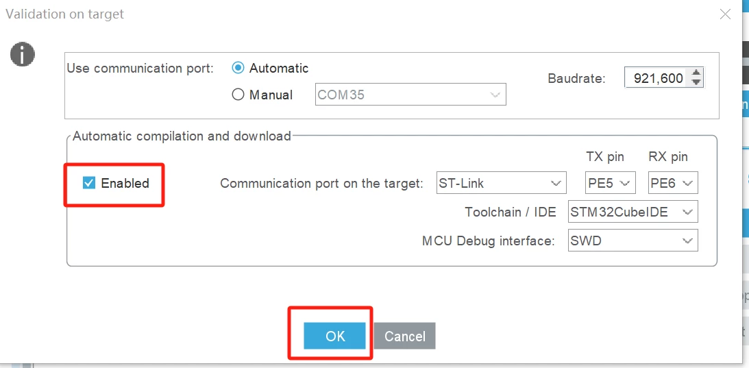

But when I go to STM32CubeMx,and click the validate on target,and check the Enabled,I still get the previous issues ,like this:
when I get the previous issues, I found that the config.json has been modified to like this:
  "gdb_server_path": "E:/ST/STM32CubeIDE_1.18.1/STM32CubeIDE/plugins/com.st.stm32cube.ide.mcu.externaltools.stlink-gdb-server.win32_2.2.100.202501151542/tools/bin/",
    "gcc_binary_path": "E:/ST/STM32CubeIDE_1.18.1/STM32CubeIDE/plugins/com.st.stm32cube.ide.mcu.externaltools.gnu-tools-for-stm32.13.3.rel1.win32_1.0.0.202411081344/tools/bin/",
    "objcopy_binary_path": "E:/ST/STM32CubeIDE_1.18.1/STM32CubeIDE/plugins/com.st.stm32cube.ide.mcu.externaltools.gnu-tools-for-stm32.13.3.rel1.win32_1.0.0.202411081344/tools/bin/arm-none-eabi-objcopy.exe",
    "cubeide_path": "",
    "compiler_type": "gcc",
    "cubeProgrammerCLI_binary_path": "E:/Program Files/STMicroelectronics/STM32Cube/STM32CubeProgrammer/bin/STM32_Programmer_CLI.exe",
    "iar_binary_path": ""
 As I have validate on target successfully by the first way(above-mentioned),
why it can generate this problem by use STM32CubeMX?
Is there any differences between two way?
Thanks!!!

cxfAuthor
Aug 14, 2025 1:38 AM UTC
Hi  @SlothGrill
Thank you for your help very much!!!
The two methods  are like this:
First method:
  1. Go to: C:\Users\<your_user>\STM32Cube\Repository\Packs\STMicroelectronics\X-CUBE-AI\10.2.0\scripts\N6_scripts\
  2. Copy your model to the model folder (or directly in N6_script folder)
  3. Run the generate command:
    stedgeai generate -m your_model --target stm32n6 --st-neural-art
  4. Run the n6_loader.py script with DK board plugged in dev mode:
    python n6_loader.py
  5.  Run the validate on target command:
    stedgeai validate -m your_model --target stm32n6 --mode target -d serial:921600
Second method:
  1:go to stm32cubeMX,click the validate on target,and check the enabled,the click ok like this
The results is that I validate on target successfully by the first method,but get a problem by the second method.
I think the reason is that  config.json has been modified to  "cubeide_path": "".but i do not know what lead to this
phenomenon?
Thanks!
SlothGrill
Aug 18, 2025 8:03 AM UTC
Hello
Agreed, it's a bug on X-Cube-AI, then, as setting the path to "" will most likely lead to buggy flow.
I guess X-Cube-AI checks if cubeide has been installed on "standard" paths (i.e. not E:), and fallback to setting the config to "" when not found.
We will post a bug for that.
Thanks.
