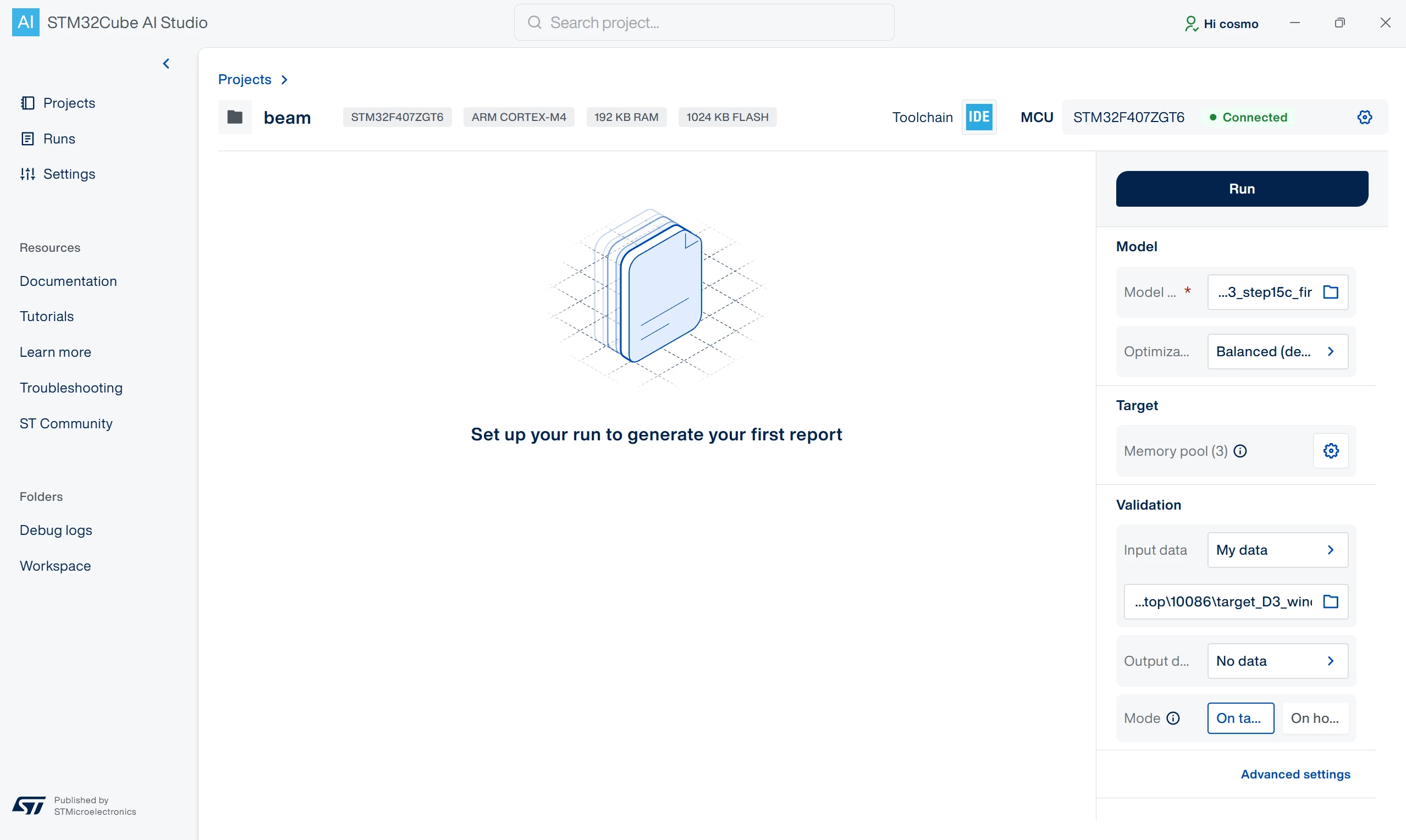

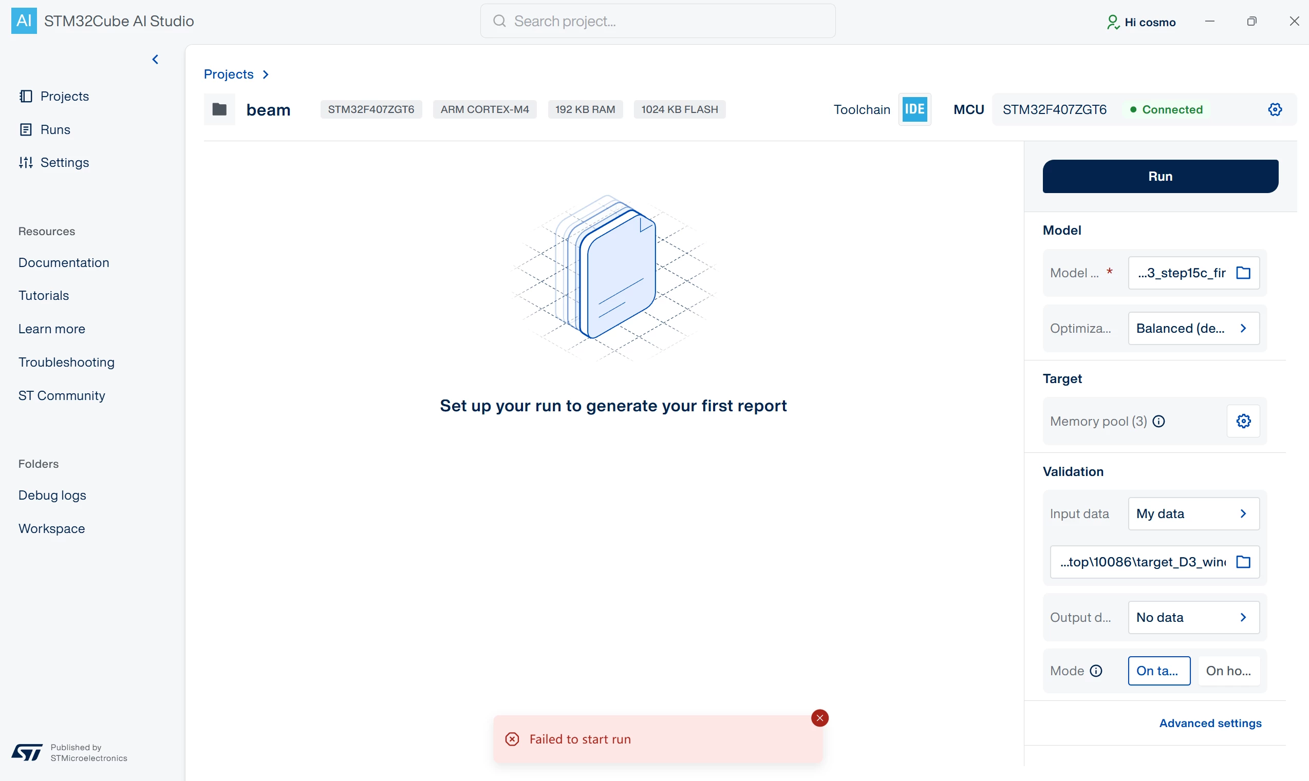

The problem occurs when I use the On Target mode in STM32Cube AI Studio.
我在尝试用STM32Cube AI Studio运行一个STM32F407ZGT6项目时遇到了“启动失败运行”错误,我不确定问题的原因。一开始
运行正常,但之后错误一直出现。使用“主机”模式时
,它正常工作。
2026-07-13 10:49:46 错误:以下路径中找不到4.0.0版本的可执行文件:C:/*ST*/*STEdgeAI*/4.0,C:/*ST*/*STEdgeAI*/*
2026-07-13 10: 49:47 错误:以下路径中找不到4.0.0版本的可执行文件:C:/*ST*/*STEdgeAI*/4.0,C:/*ST*/*STEdgeAI*/*
2026-07-13 11:14:59 错误:从公共IP获取国家时出现错误:获取失败
2026-07-13 11:15:00 错误:以下路径中找不到4.0.0版本的可执行文件:C:/*ST*/*STEdgeAI*/4.0,C:/*ST*/*STEdgeAI*/*
2026-07-13 11:15:01 错误:以下路径中找不到4.0.0版本的可执行文件:C:/*ST*/*STEdgeAI*/4.0,C:/*ST*/*STEdgeAI*/*

Hello ​@Cosmos
It may be due to the fact that since you are not using an official ST-LINK, enumeration returns a product vendor other than STMicroelectronics.
To be sure about that, feel free to execute this command in a PowerShell:
Get-CimInstance Win32_PnPEntity | Where-Object { $_.Caption -match 'COM\d+' } | Format-Table Caption, Manufacturer, DeviceID
If enumeration returns, for example, Alientek, instead of “STMicroelectronics” the best would be to get an official ST-LINK.
I still take the point to see if we can support this.
Best regards,
Yanis

Do you have a ST link on your board?
Have a good day,
Julian
​In order to give better visibility on the answered topics, please click on 'Accept as Solution' on the reply which solved your issue or answered your question.
CosmosAuthor
Aug 7, 2026 2:06 PM UTC
Hi Julian,
No, my board does not have an ST-Link built-in. I'm using an ALIENTEK ST-LINK V2 emulator/debugger to connect to the board.
But the very first time I followed the tutorial to set up STM32Cube AI Studio, it did seem to connect and work successfully — only that once. Ever since then, I keep running into the issue shown above.
Do you have any idea what might be causing this one-time-success behavior, or how I can get it working again?
Thanks,
Cosmos
