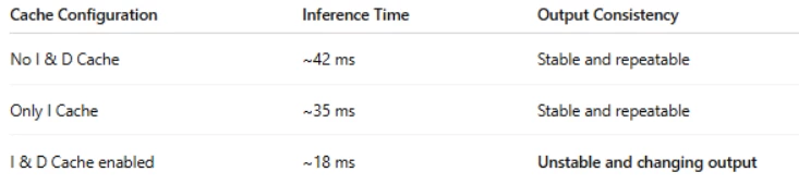

1. YOLOv8n on NPU
Note: The NPU cache itself appears unrelated — it always gives stable results.
The issue seems to stem from
CPU-side D cache (DCACHE).
Conclusion: Enabling DCACHE leads to output inconsistency in NPU, regardless of whether cache invalidation or cleaning is applied.
Personally, I suspect the inconsistency arises because the software epoch controller may rely on DCACHE for acceleration, but the NPU operates faster than the cache system, potentially leading to race conditions or stale data being used.
Without DCACHE: inference is slower but stable.
With DCACHE: faster but results are unpredictable.
Interestingly, enabling the D-cache is actually recommended in ST’s own template project for the DK board. Therefore, I suspect that even ST might not be aware that this could introduce randomness in the inference results.

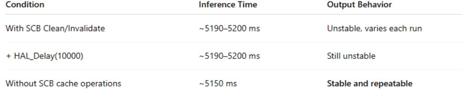

2. YOLOv8n on CPU
Only D-cache management (cache invalidation and cleaning, before and after inference) affects output. Specifically:
SCB_InvalidateDCache_by_Addr(in_data, ...);
SCB_CleanDCache_by_Addr(in_data, ...);
SCB_InvalidateDCache_by_Addr(out_data, ...);
Note: A HAL_Delay was added after each SCB cache operation to test whether the inconsistency was caused by a delay in the completion of the Clean or Invalidate processes.However, its not the reason.
Conclusion: Applying SCB D-cache management seems to disrupt cache content, possibly interfering with model output consistency. Without these operations, the cache appears to work well and produces constant results.

Thanks for the update.
Could you tell us a bit more about how/when/what you do to do cache maintenance ?
Most likely, if you do an inference using NPU, what you would need to do is something like:
  1. Retrieve your image from UART, and perform your sanity checks (be careful, at this time, the image -or a part of it- will most likely stay in the cache, and not be written to memory).
  2. CLEAN CACHE (i.e. flush the cache to the memory) ... (but do not invalidate it before cleaning, as shown in your snippets !)
  3. start the inference.
This is not true, the epoch controller does not have access to CPU-D$: data is fetched by DMAs that are independent from the CPU (stream engines of the NPU).
Could you try to clean & invalidate, but not invalidate & clean and tell us if this fixes your issues ?

Thanks a lot for the help, this is really really helpful. By only cleaning before the reference and then invalidate after the reference, the randomness is gone. Thanks a lof again for the excellent solution and explanation!!!!!!!
