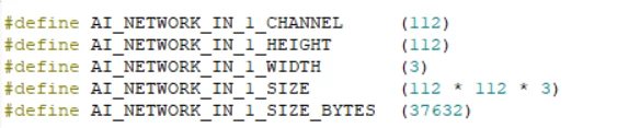

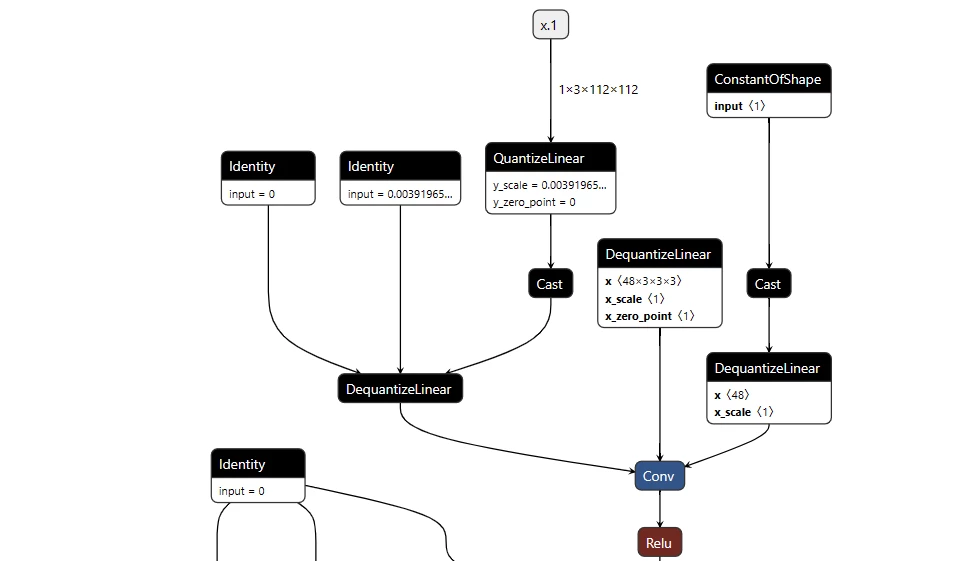

the input channels of the model is three,but got 112,why is that

    fauvarque.daniel
    May 22, 2023
    can you share your network or disclose the input shape as seen with a tool like Netron.
    Thanks

    here with my model.onnx (version 12) created by pytorch 1.12.1 && cuda11.3 plus C Codes  created by STM32CubeMX.ai 8.0.1
    fauvarque.daniel
    May 22, 2023
    Sorry if you put an attachment it didn't go through, I can't see it.
