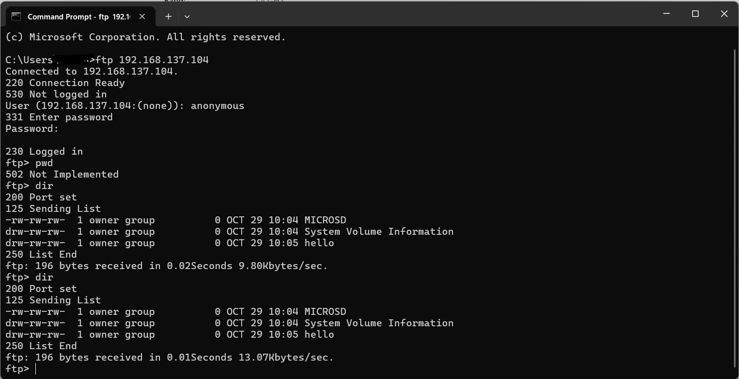

Issue#4: FTP retrieval in this situation, i have only until WIFI connect command and it is connected. Following the ST WIFI FTP connect guide for datalog2, my device is not responsive. Here is the FileZilla screenshot
or inside command prompt
C:\Users\xx> ftp 192.168.137.104
Connected to 192.168.137.104.
220 Connection Ready
530 Not logged in
User (192.168.137.104:(none)): anonymous
331 Enter password
Password:
230 Logged in
ftp> dir
200 Port set
550 Bad Directory
ftp>

A small update to the FTP retrieval.

In my case, I am using Datalog2 and STwinbox. I believe this supports FTP. I have referred to the documentation of PDETECT only to know how to enable FTP server using the ST BLE Sensor app. My final target is to use PnPL command to enable the FTP server.
So far I am using USB connection to send PnPL commands for WIFI and FTP.
After sending these commands the STWINBOX connects to wifi and i could view data in FTP as i described already, but those commands doesn’t show any PnPL response true back to my Terminal instead prints out „None“  and no more commands can be sent such as „ get all“ status commands, because the Python SDK can not find the board. Meantime, i could see the FTP server enabled ( i have to get the IP from my router and then using Command prompt FTP … )
The problem is, if i can not send any more commands such as „get  all“ i can not automate the process without knowing the IP of the board.
Thus, I am asking if my process of connecting to wifi or the PnPL messages are valid in sequence.
