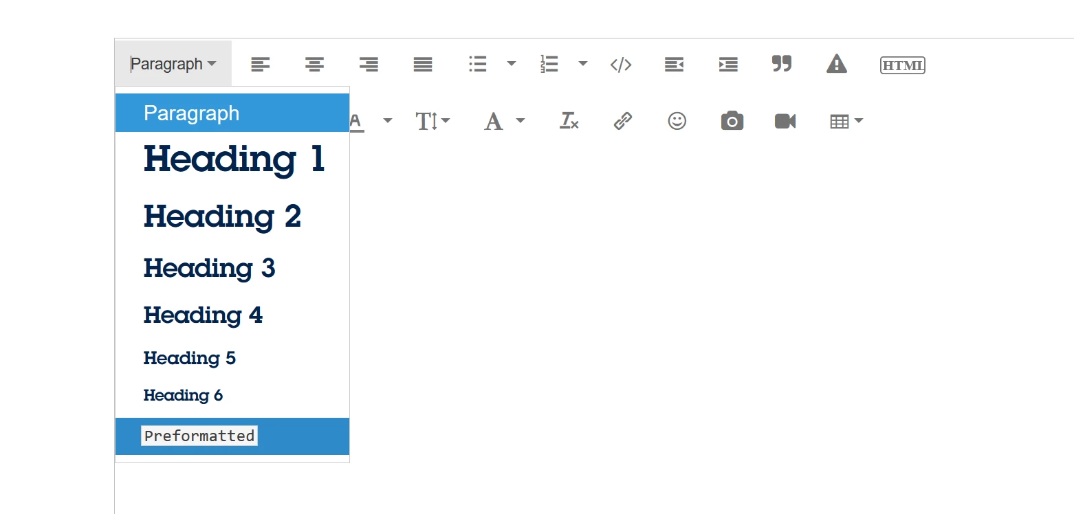

Please use formatting in your original post.
No specific language (for instance terminal output):
A programming specific language (such as C/C++):
