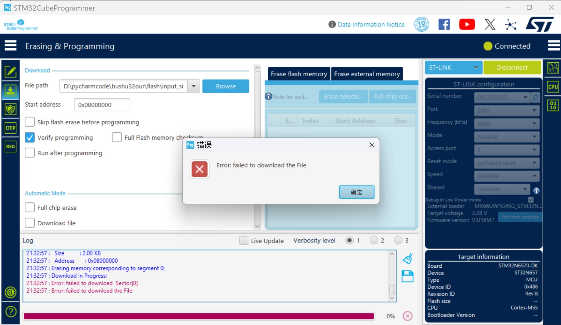

Hello, I am currently trying to write my input_data_int8.bin file to flash, but I keep getting an error that says 'Error: failed to download the file'. How can I fix this? Thanks!

Hello @llcc,
did you select the external loader for the DK board?
(Click on the bottom left EL icon)
