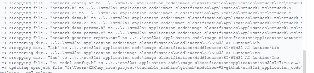

Sep 9, 2025 10:11 AM UTC
You should deploy C source files to a default project which is a part of model-zoo, build it and flash your board.
Unfortunately I don't remember all the correct paths for this files.
For start If you trained your own default model as your previous output says, you can deploy sources with the same script and user_config.yaml. Change model_path to:
"YOUR_PATH\image_classification\src\experiments_outputs\YOUR_TRAINING_DATETIME\quantized_models\quantized_model.tflite"
Change operation_mode from chain_tqeb to deployment.
Check "tools" and "deployment" sections are correct, save user_config file and run the script.
If script will work files will deploy to the project and you can open it and see all the paths you need.
Screenshot is from the step "3.6 Deployment"
Also you can try to download not just sources from the site. There is an option to get the cube project with your sources. You can download the project, see all the paths you need, than find the same paths in a default model-zoo project and copy your files.
