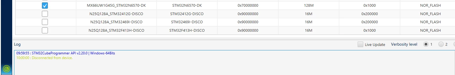

Hello ​@wbotros
Use the object detection example, which can be downloaded from this link.
It is a ready-to-use application that detects people.
To use the application, follow these steps:
  1. Download the project.
  2. Open STM32CubeProgrammer.
  3. Make sure that the correct external loader is selected, as the captions show.
  4. Put the board in development mode by setting the BOOT1 switch to position 1-3.
  5. Connect to the board.
  6. In the Erasing and Programming window, browse to the .HEX file at "object_detection\STM32N6\Binary\STM32N6570-DK\STM32N6570-DK_GettingStarted_ObjectDetection.hex" , and then click Start Programming.
Disconnect the board, set the BOOT1 switch back to position 1-2, and power cycle the board.
