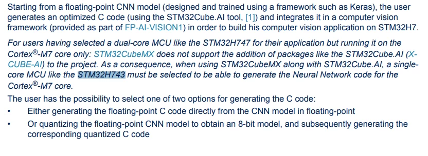

Currently using the STM32H747I-DISCO with camera to explore using computer vision for people detection. I have already successfully used one of the example NN (found in the FP-VISION-AI1) and now look to use the X-Cube-AI to integrate further tensorflowlite NNs.

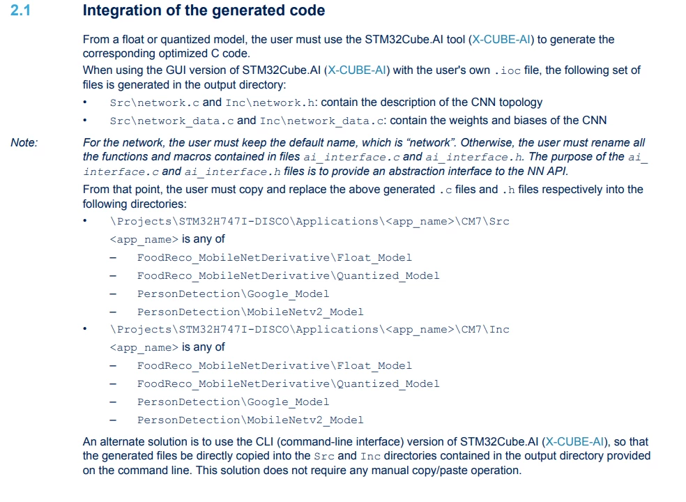

I'm working off of the Artificial Intelligence (AI) and computer vision function pack​ for STM32H7 microcontrollers - User manual and it states:

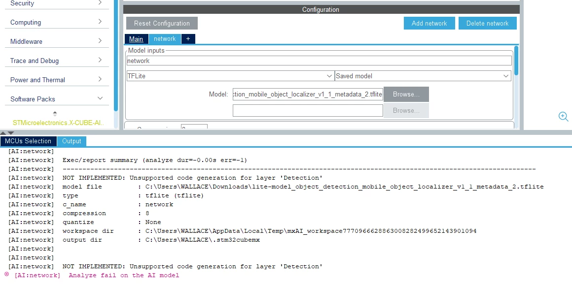

As such I have loaded CubeMX for the STM32H743ZITx to allow Cube-AI functionality, however, when loading various official tensorflowlite files, I always get the same error message when analysing the model:
The .tflite files can be found at: https://tfhub.dev/s?deployment-format=lite&module-type=image-object-detection

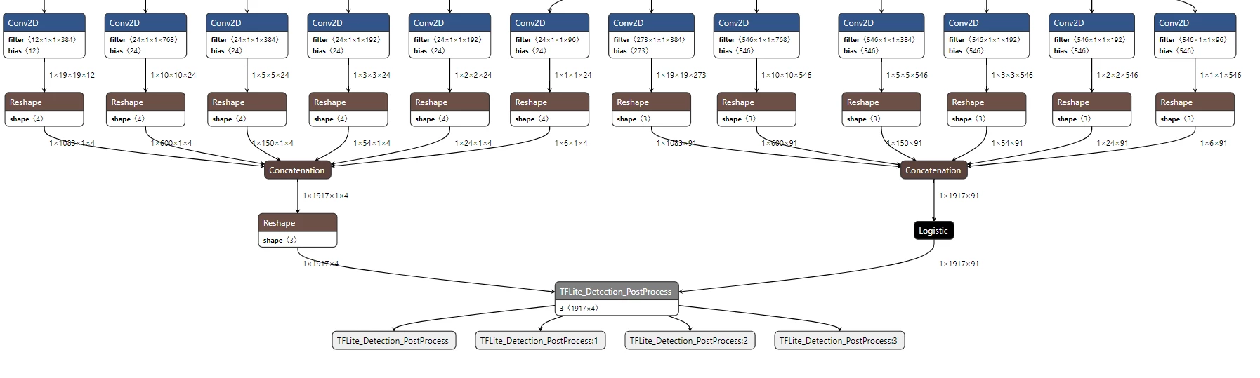

EDIT: could this issue be with the TFLite_Detection_PostProcess node as shown below in netron:
Any help would be much appreciated.
