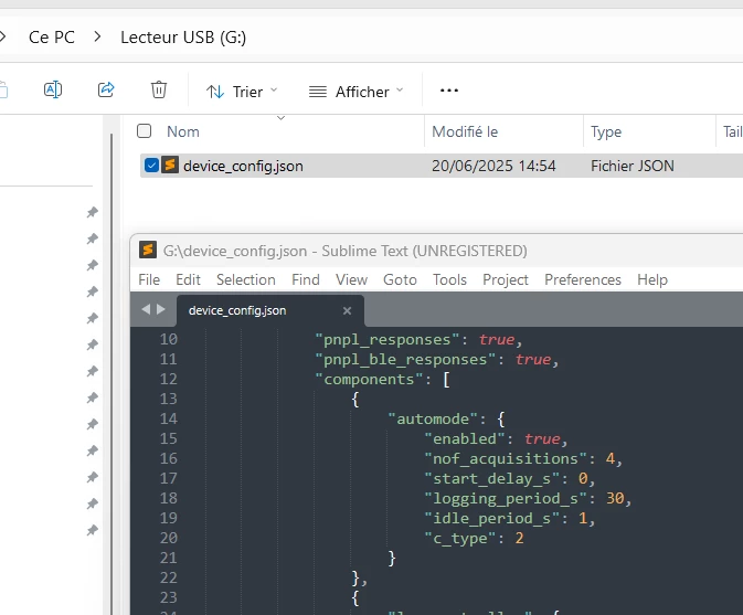

I'm opening this issue because I log data with STEVAL-STWINKT1B (battery-powered), and I haven’t been able to get the automode feature working as described in the QuickStart Guide. Here are the steps I followed:
  1. Formatted my SD card (SanDisk Extreme 256 GB SDSQXCD-256G-GN6MA) to FAT32 with a 32K allocation unit size;
  2. Configured the device_config.json file as shown below and copied it to the root directory of the SD card (which appears as “G:” in my system). Based on the config, I expected to get 4 folders with logs (one per acquisition), each containing 30 seconds of data logging, though I’m not totally sure this is the correct behavior to expect?

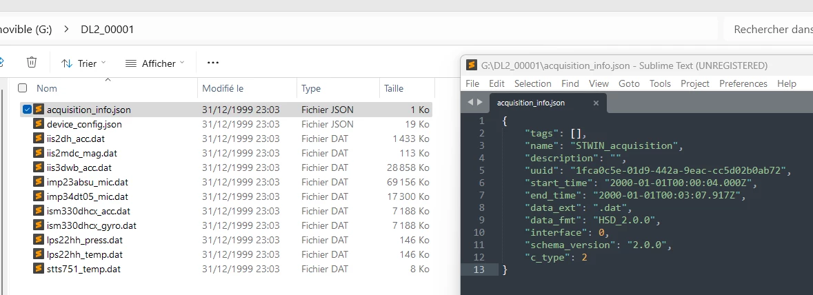

Result:
When opening the SD card (G:), I only see one folder, DL2_00001, which contains non-empty .dat files.
In G:/DL2_00001/acquisition_info.json, the start_time and end_time show a duration of about 3 minutes, as expected (see below).

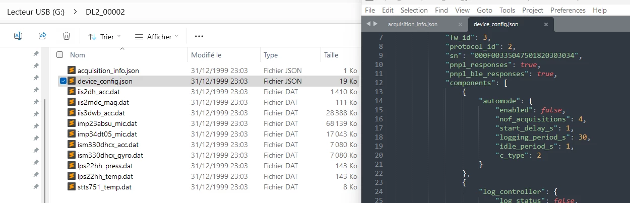

There’s also a new config file at G:/DL2_00001/device_config.json (see below), and interestingly, it shows "enabled": false instead of true, "start_delay_s" turns to 1 instead of 0, but all other parameters (nof_acquisition, ..) are the same than G:/device_config.json. That’s why I suspect the logger is reading the config file located at the root (G:/device_config.json), but for some reasons not using the automode as expected.
I also tried two other experiments:

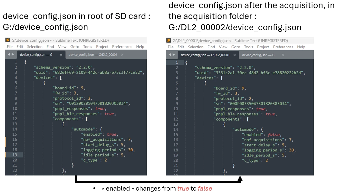

######## 2 ########
I used the exact same parameters for automode as in the Quick Start Guide (see picture below), and repeated steps 1 to 5. For step 6, I waited 5 minutes, which is more than enough (i.e., 7 * 30 = 210 s = 3.5 minutes).
I noticed that a new device_config.json file appears in the acquisition folder: G:/DL2_00002/device_config.json. In that file, "enabled" is set to false, even though it was set to true in the original config at G:/device_config.json.
So it seems the logger does read the config file from the root directory, but for some reason, it modifies certain automode parameters internally, like "enabled" or "start_delay_s". I have no idea why this happens.
