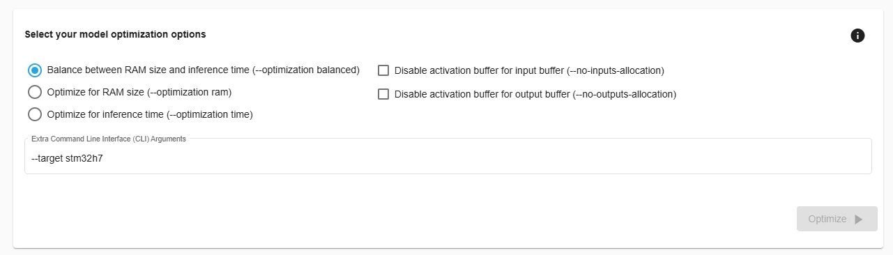

Hello expert, I’m using the latest version of stedgeai-dc.st.com (online) to compile my CNN model but by default, choosing the STM32 MCUs, the target is F4 family while I’d compile and optimize my  code for H723ZG board. It seems there is no way to change the target board…. why? and how can I do it? indeed If I see the stdout.txt generated at the end I see:
>>> stedgeai generate --model tiny_resistor_cnn.onnx --optimization balanced --target stm32f4 --name network --workspace workspace --output output
ST Edge AI Core v4.0.1-20581 7ed50de05
so it’s not optimized for my board.
Could someone help me please?
Many thanks and regards
Lorenzo

Hello ​@loarri
During this step, the target does not matter a lot, however, if you want to override it, you can go in the “Optimize” step, and write in “extra CLI arguments” settings you want to override:
Best regards,
Yanis
