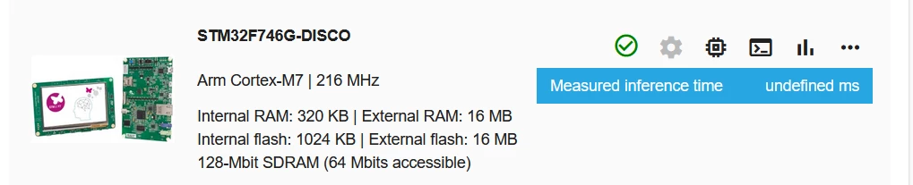

ST Edge AI Developer Cloud Benchmark not working with STM32F746G-DISCO
Hello! I am working with the developer cloud to benchmark some models' inference speed in a controlled environment. It was working well for the STM32F746G-DISCO board until a couple of days ago, when it just kept saying that my model has a measured inference time of "undefined ms."
I was wondering if this issue was known and whether it was possible to benchmark the inference time of my model locally on my board with the same environment as the developer cloud. I am aware of the local benchmarking tool in the ModelZoo services, but it seems to only give the estimated memory footprints, not the inference time.

Jun 23, 2025 2:05 PM UTC
Is it possible to share the version you used as well as the model ?
Best regards
Yanis
​In order to give better visibility on the answered topics, please click on 'Best answer' on the reply which solved your issue or answered your question.
mimikAuthor
Jun 23, 2025 3:14 PM UTC
Thank you for the reply. This error has occurred to me for every model I've tried so far. A model that I have confirmed this error to happen with is the "st_yolo_x_nano_192_0.33_0.25_int8_object_detection_COCO_2017_Person.tflite" in the ModelZoo. The version of ST Edge AI that I used is 2.1.0-20194 329b0e98d, but I also tested it on 2.0.0-20049, and it also did the same thing. Everything was working with the same version 2.1.0-20194 329b0e98d for me on the 18th.

hamitiya
Jun 24, 2025 7:05 AM UTC
Thanks for your reply.
This output seems incomplete, it looks like the execution failed unexpectedly at the end. Also, it does not happen on other boards
I am investigating the issue.

hamitiya
hamitiyaBest answer
Jun 24, 2025 7:37 AM UTC
Could you please retry  and see what happens on your end ?
I was able to reproduce the issue and after an update it is now unstuck.
Best regards,
Yanis
mimikAuthor
Jun 24, 2025 8:06 AM UTC
Hi!
Yes, Ive tried it on some of my models and everything works now. Thank you so much!
