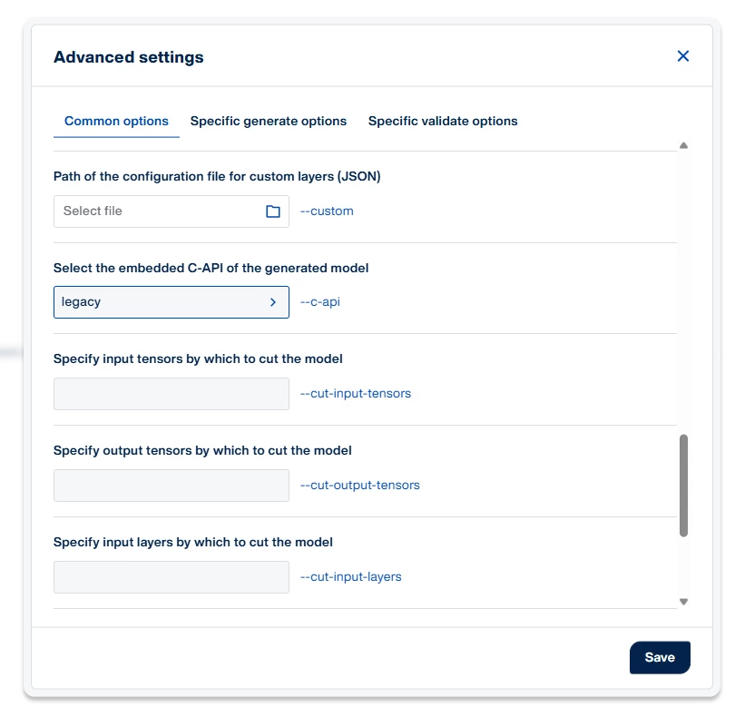

I am using STM32H745, STM32CubeAI Studio 1.3.0, ST Edge AI Core v4.0.1, as recommended on STM web site I am moving my code from X-CUBE-AI (generated by CubeMX) to ST Edge AI v4 (generated by AI Studio).
I need to extract output of intermediate layer, and I used to use platform observer API for that.
Can I keep using with st-ai code base (ai_platform_observer_register)?
Should I switch to stai_network_set_callback() ? Is it supported for production applications? Will this API remain available in future ST Edge AI Core versions?

Hi ​@Linas_S,
You can still use the legacy api.
In STM32CubeAI Studio, you can select it in “Advanced Settings”
This API should remain usable until all its features are available in the new one.
But we will probably stop support it one day.
So if you can migrate to the new one and manage to do everything you want, this is probably better.
