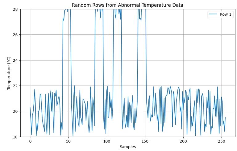

I'm currently working on a Nucleo-F446RE board and wish to implement a real-time (using CMSIS-RTOS) anomaly detection method using the following, simulated (random numbers essentially, generated via a Python code, data separated by tabulations) time series data :
Abnormal temperature data (randomly generated)Abnormal temperature data (randomly generated)

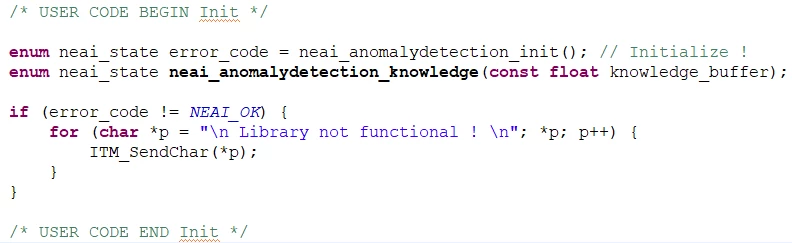

Following the documentation in order to implement said detection model under STM32CubeIDE, I chose to use the knowledge used while benchmarking the different models, as I don't have a way to get real data yet :
Model initialization with knowledgeModel initialization with knowledge

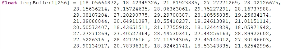

No errors up till here. In order to correctly determine whether my model is functionnal or not, I chose to use a random buffer of samples generated using the Python Code (just for illustration purposes, here below is an example) :
Abnormal buffer of samples (example)Abnormal buffer of samples (example)
And thus I can try to detect anomalies using the following code :
Anomaly detection functionAnomaly detection function
Unfortunately, whether I'm using an abnormal, normal or even an array with only constant values, the similarity was always of 100 :
Anomaly detection resultsAnomaly detection results

  • The knowledge is not correctly integrated in the initialization phase

In my case, it was a mix of multiple issues which led to a constant similarity of 100 :
  • The model was not correctly trained on the knowledge (knowledge_buffer → knowledge)
  • The anomaly detection model was at fault : it was overfitted, as it had a difficult time generalizing to slightly different data
I then tried training an nCC model, which allowed a pseudo-detection of anomalies. Although this is not the optimal way of detecting anomalies, it at least unblocked me.
