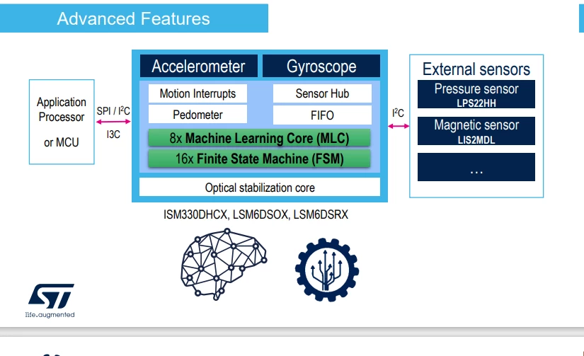

Ciao @FKara.3 ,
When sensor hub mode (mode 2) is enabled, both the primary I²C/MIPI I3C®/SPI (3- and 4-wire) slave interface and the I²C master interface for the connection of external sensors are available. These are the connections needed:
In AN5922 you can find a guidance from page 71.
If this helps you, please mark my answer as "Best Answer" by clicking on the "Accept as Solution" button, this can be helpful for Community users to find this solution faster.

AN5922 has a dedicated part for "Sensor hub mode example"
