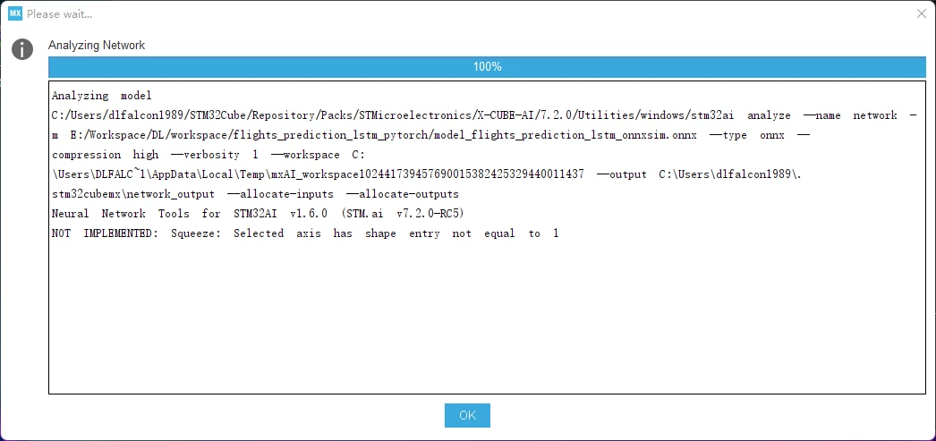

Problem when verifying ONNX model with STM32Cube.AI 7.2.0 (Not IMPLEMENTED: Squeeze: Selected axis has shape entry not equal to 1)
  • August 23, 2022
  • 1 reply
  • 1437 views
0693W00000QOIcjQAH.pngDear support-team:
I've created a model which consists of only a LSTM layer and a linear layer with Pytorch, and convert it into ONNX model. But when I tried to verify it with STM32Cube.AI, it just print "Not IMPLEMENTED: Squeeze: Selected axis has shape entry not equal to 1". As I've checked the model, the shape entry which I try to squeeze is 1, what may the cause the problem? Sincerely for your help.
Pytorch version: 1.8.2
ONNX version: 1.10.0 (With Opset 10)
STM32Cube.AI version: 7.2.0
    1 reply
    fauvarque.daniel
    September 13, 2022
    Thanks for reporting this issue,
    We had an issue with this model due to the insertion of a Transpose layer before and after the LSTM. This determines a wrong shape inference for the successive layers depending on axes (e.g. Squeeze).
    We have fixed the problem in our upcoming 7.3 version that will be public by beginning of October
