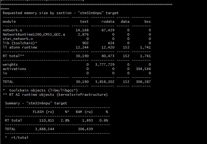

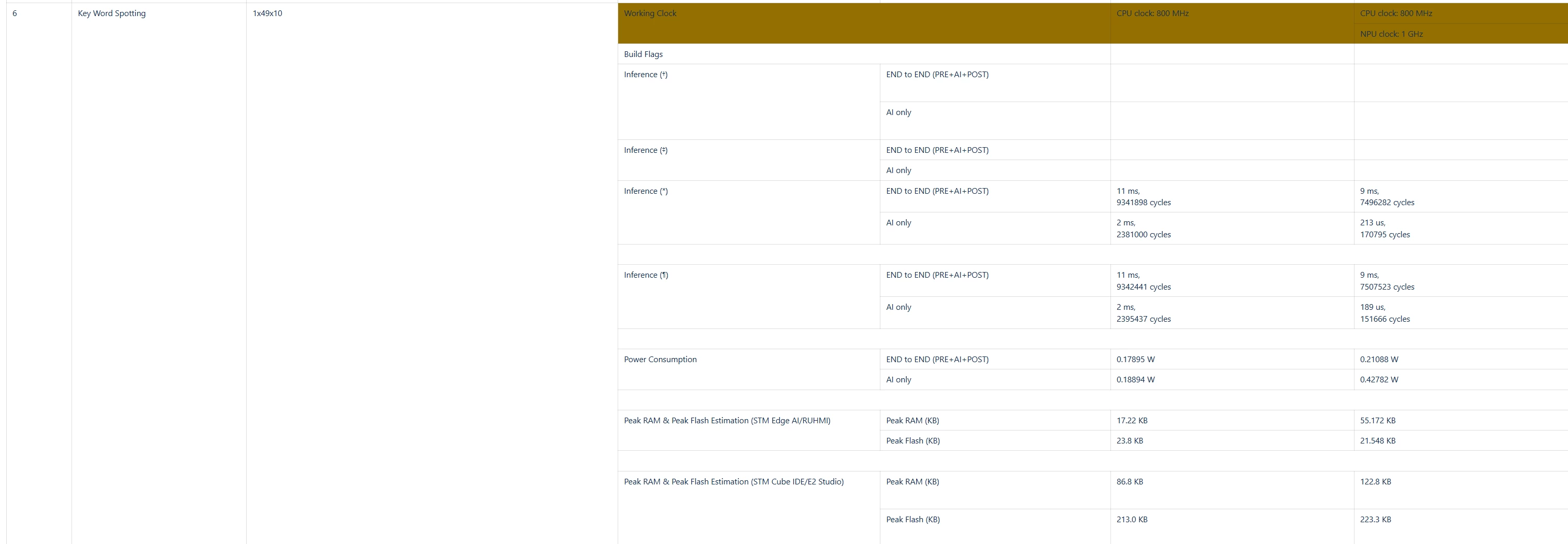

How do I measure the peak RAM and peak Flash usage of an AI model?
I need to calculate peak RAM and peak Flash from the IDE, but the model generated by ST Edge AI is in HEX format and is not included in the IDE's reported size. So, I'm adding the HEX file size to the IDE's peak RAM and peak Flash figures — is this approach correct? Details are shared below.
KWS cpu+npu
IDE
Flash = text + data = 205,404 + 1,616 = 207,020 bytes ≈ 202.17 KB
RAM  = data + bss = 1,616 + 102,040 = 103,656 bytes ≈ 101.23 KB
For cpu+npu we flash the model in  hex format, so we need to add the peak ram and peak flash of hex file with IDE peak ram and peak flash.
 model size -
Total Peak Ram and Peak Flash
  • Peak RAM = (103,656 + 22,065 =  122.77 KB)
  • Peak Flash = (207,020 + 22,065 =  223.72 KB)

Hi ​@visakh,
This is correct.
For information, you have all of this directly in the generate report. for example:
Have a good day,

I have one more query ,For some models the ram and rom is significantly larger in project vs the model requires
Is it driver or library?
RAM / ROM = Model Size + Drivers & Libraries + Application Code- is this correct??
visakhAuthor
June 30, 2026
Hi ​@Julian E.
When you measure the model parameters from ST EdgeAI vs Peak RAM on STM IDE , the difference is high, is that attributed to the model inference library + the ST's NPU driver?
