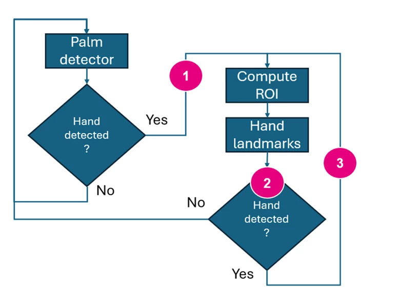

the flow is as follow:
  1. The output of the “Palm detector” are multiple bounding boxes. We select one and this is a small bounding box (in red in the demo).
    We are then resizing it and rotating the image to have the hand in this position ✋(this kind of is the green bounding box)
    This is then sent to the other model
  2. The output of the “Hand landmark model” is both the landmarks and if a hand is detected
    if the confidence of a hand being in the image too low => we go back to the hand detector (“No” path)
    Else, we get a similar bounding box as the one mentioned in point 1 (“Yes” path)
  3. We apply the same preprocessing (because the hand may have moved a little) => resize + rotation before feeding it again in the “hand landmark” model
We do not support epoch level parallelization (run 1 epoch of model1, then run 1 epoch of model2). Maybe with a RTOS you could do it.

Julian E.
Julian E.Best answer
Jul 28, 2026 3:22 PM UTC
Hi ​@Rutva Patel,
Please look at this example:
STMicroelectronics/x-cube-n6-ai-hand-landmarks: An AI software application package demonstrating hand landmarks detection use case on STM32N6 product.
We use 2 models: hand detection, then hand landmark with some ROI between the 2 models.
I would suggest giving it to claude code or any good LLM and it should be able to answer any of your questions
For the best way to handle ROI, as I said ask a LLM to see what is done in the package. This is also described here:
x-cube-n6-ai-hand-landmarks/Doc/Application-Overview.md at main · STMicroelectronics/x-cube-n6-ai-hand-landmarks
Have a good day,
Julian
​In order to give better visibility on the answered topics, please click on 'Accept as Solution' on the reply which solved your issue or answered your question.
