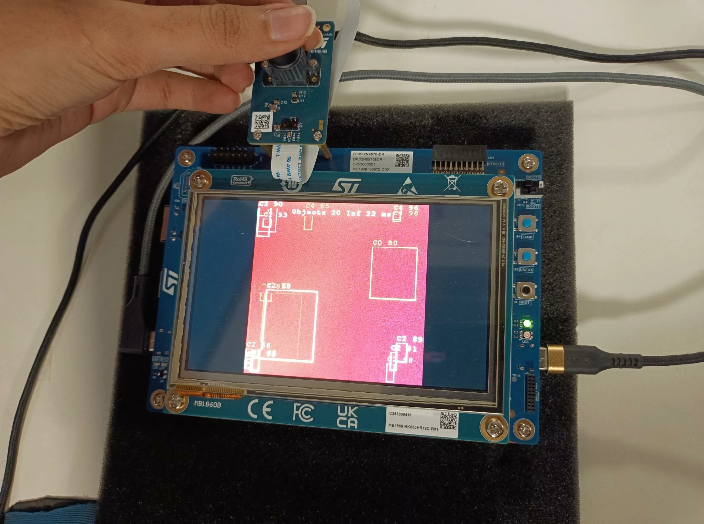

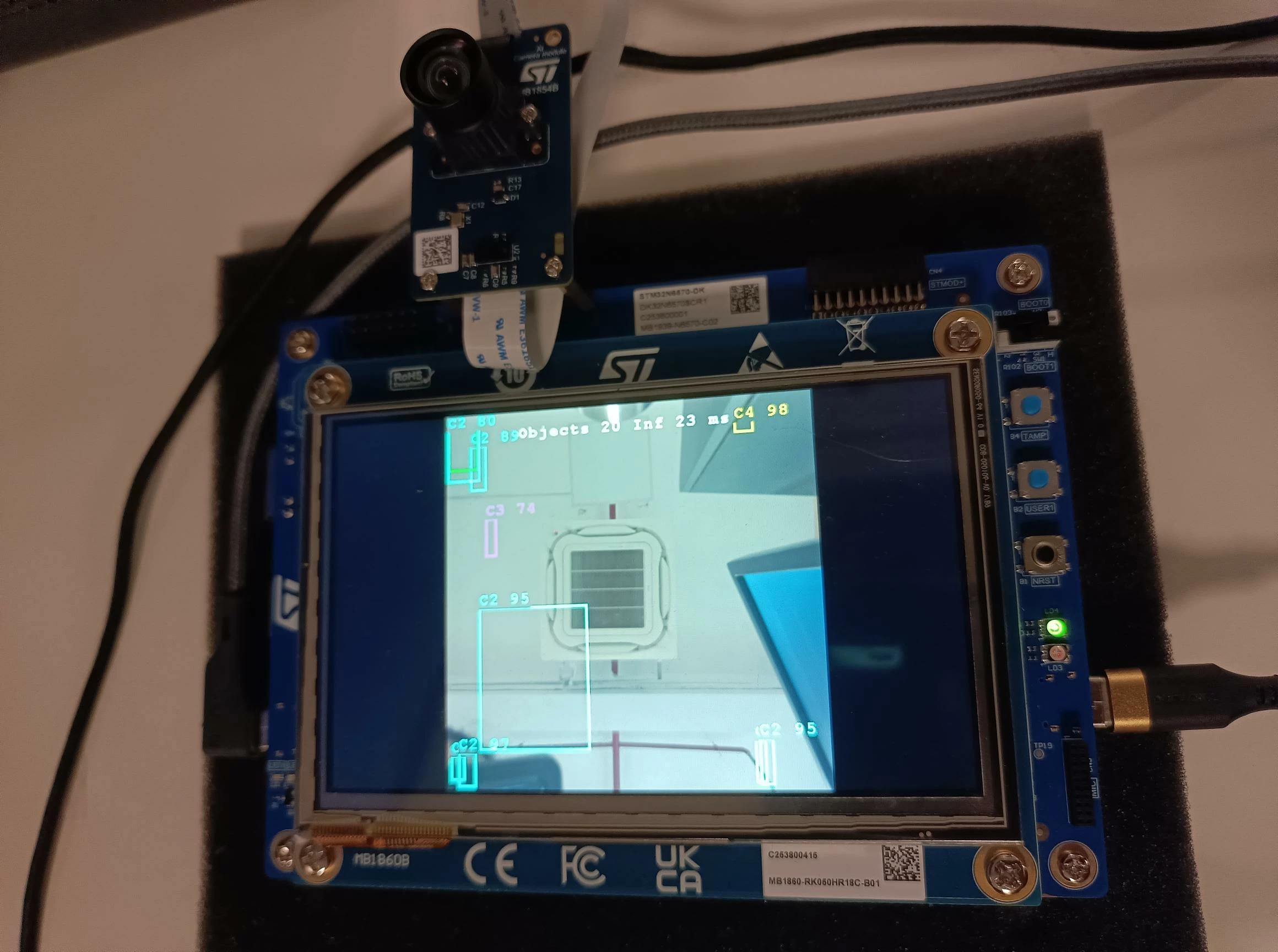

  1. The bounding boxes are not displayed at the correct positions on the camera image.
  2. The detected bounding boxes appear to be shifted or incorrectly scaled.
  3. Even when the camera is not viewing any object (or the camera feed is unclear), random bounding boxes continue to be displayed.
  4. These false detection remain on the screen even though there should be no valid detection.

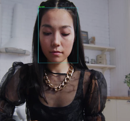

I also tested the quantized ONNX model on my PC using the same model.
The ONNX model produces correct detection results:
  • Bounding boxes are in the correct positions.
  • No false detection are observed when no object is present.
This suggests that the model itself is working correctly, and the issue is likely related to the STM32 deployment, post-processing, or output decoding.

I am attaching:
  • Screenshot of the quantized ONNX model output on PC (correct detection).
  • Screenshot of the STM32N6570-DK display showing the incorrect bounding boxes.
Any guidance or example project for deploying YOLO-FastestV2 on STM32N6570-DK would be greatly appreciated.

Hello ​@Rutva Patel,
I would suggest as a first step to use STM32cube AI Studio and your board connected.
Import data in the tool as a npz (some examples preprocessed you want to test).
After the run, in the table containing the COS for each output, you can download the outputs.
I would try to postprocess them in python first to see if you get the correct bounding box.
With any LLM you should be able to get a code to get the output and apply NMS.
If everything is correct, then, I would get the application example from the run in Cube AI studio and start from there.
You can also look at the N6 examples for object detection.
STM32N6-AI | Software - STMicroelectronics
I think the base model is a YoloX, which is pretty similar.
have a good day,
Julian
