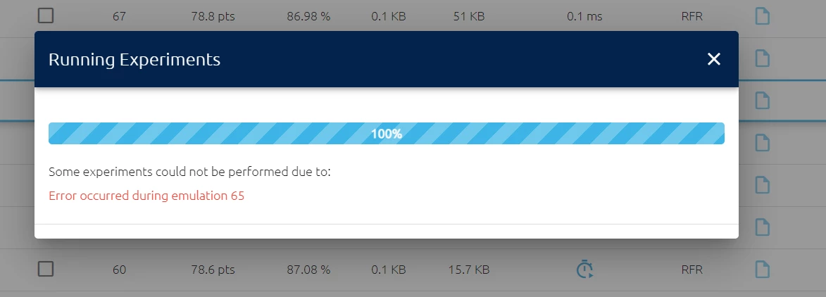

    I have attached image file for this one, During the validation process There seems to be an Error with the enumeration. please see attached file form more information.
    The Error at times can be 27, Where do I get more information about these Errors.

For the emulator error, I believe that the error number is just the library number you are testing.
Can you please import the test files in the "Signal step" to make sure that they are correct (without line to delete).
If they are not, delete the lines indicated and download the cleared files before doing a new experiment.
For multi libraries, this will be added in next release in the coming months.
