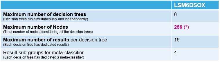

I'm wondering what the hard limit is for the MLC configuration in the LSM6DSOX. I'm using Unico 9.0.0.0 to configure four IIR2 filters and I loaded 4 decision trees (basically a small random forest). The Unico software created the .ucf file successfully. But when I wrote the configuration into the LSM6DSOX, it wouldn't give me any valid values in the register that held the decision tree outputs. The valid outputs were 1, 2, and 3, and the registers would only report 0.
Is there a documented size limit on this MLC size? Even if there is a software bug in this version of Unico, it would be nice to be able to double-check to see that the .ucf file isn't configured to write past the end of the memory map.

Hi @NGern​ , the HW limitations are the below depicted ones, so you shouldn't have exceeded them with your MLC configuration (N. of decision tree <8, few features, etc).

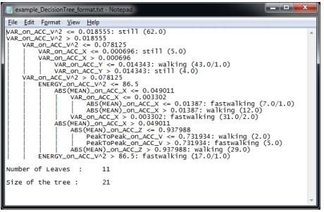

Is the decision trees you generated from your tool in the below format? Please note that the decision tree has been generated from a different tool, the format must be converted to the Weka J48 format (or to the RapidMiner format) in order to allow the Machine Learning Core tool in Unico to read the decision tree correctly (cfr AN5259, p.23) .

Thanks for the reply @Eleon BORLINI​ . Yes I did use Weka to generate the decision trees. I used the RandomForest model which generated 4 decision trees that were in the same format as the J48. An example of one of the trees from the RandomForest output is attached.
