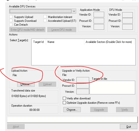

was able to solve my problem. the STEVAL-MKI109V3 firmware was outdated. earlier i tried to update its firmware but the GUI of the DFU tool didnt have a good UX (as highlighted in the image). so instead of updating the firmware i overwrote the firmware file with the old firmware image from the STEVAL-MKI109V3. as a result everytime i tried to update the image properly it would write back the old image. 0690X000009841BQAQ.png
