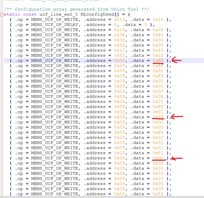

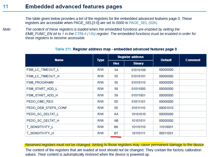

After generating my ucf file that I load to my LIS2DUX12 and verify that it works, I wanted to load the generated configuration through a microcontroller so I used the option in Unico GUI to generate the header file which later on I need to include in my project. After analyzing the content of the commands that is sending, I noticed that is sending commands to addresses not listed in the datasheet neither displayed in Unico GUI. This concerns me as these could be reserved registers and then damage the accelerometer:
Reviewing the datasheet, the highest address described is 0xB7:
Could you point me what is then wrong? Is it the documentation and Unico GUI or the generated file?

Hi @sch0bert ,
Those registers are reserved but the MLC tool is able to manage them so there isn't any risk to damage the accelerometer.

Hello @Federica Bossi
Thanks for the prompt response, what do you mean with the MLC tool? Unico GUI?
So should I trust on the registers in the generated header file?
Will these registers be documented in a new document version?

Hi @sch0bert ,
Yes Unico GUI.
You can trust on the registers in the header file.
I can point out to my colleagues that it may be useful to include these registers in future releases.
