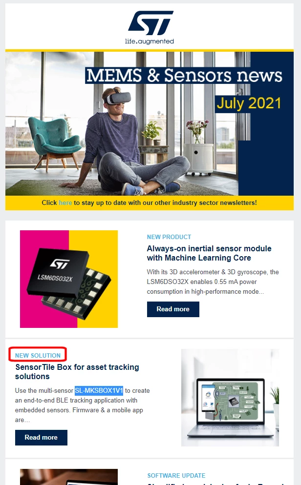

July 2021: So what's "new" about this SensorTileBox SL-MKSBOX1V1 ?
Just received this email:
We have had the SensorTileBox SL-MKSBOX1V1 since early this year (and I don't think it was new then) - so what is actually new here?

Hi @Andrew Neil​ ,
there are actually some minor changes in the factory FW (version 3.4.7) and in the STBLE sensor app (night view, possibility to set the node)
The change of the BLE module from SPBTLE-1S Bluetooth Smart connectivity v4.2 to Bluetooth application processor v5.2 (BlueNRG-M2) to is expected shortly, and this will allow to configure the BLE in a substantially different way.
Not much new indeed, but if my reply answered your question, please click on Select as Best at the bottom of this post. This will help other users with the same issue to find the answer faster.
-Eleon
