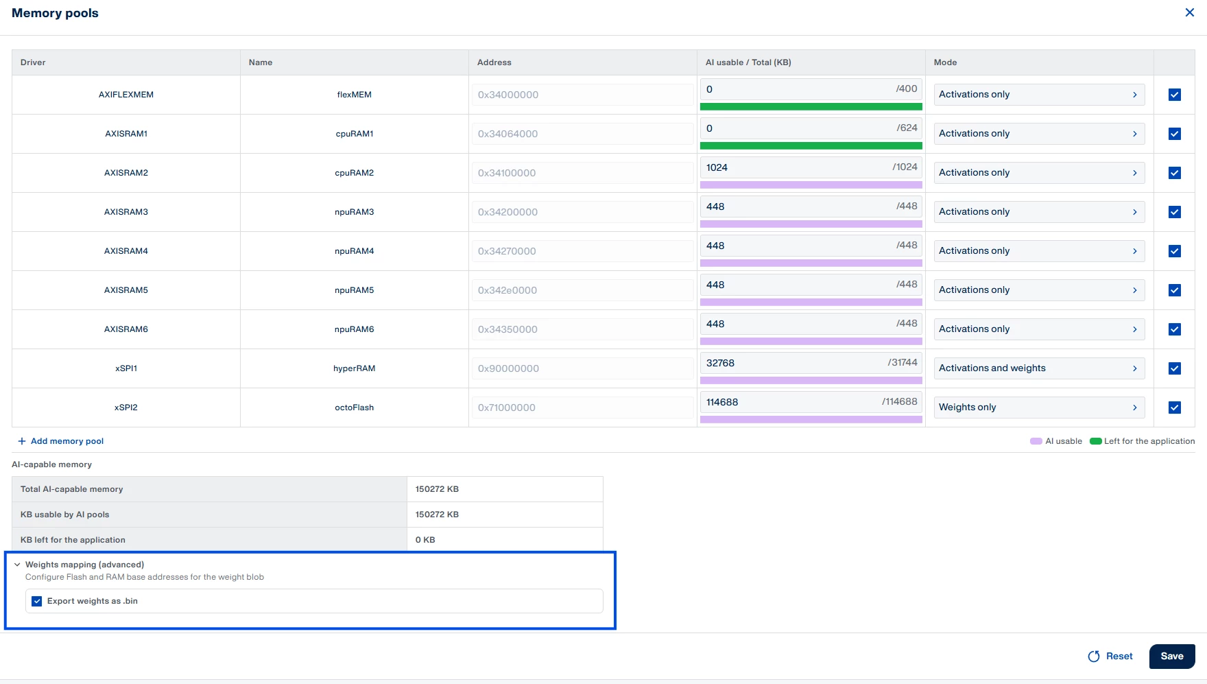

Hello  @pawatJoy
with this new update, STM32Cube AI Studio uses the ability to generate weights as C code instead of binary file.
If you want to reuse the same behavior as before, you can go to:
Target > Memory Pool
and, at the far bottom, under Weights Mapping:
Usage of C file is easier to integrate in your application since you can ship one unique .elf / .bin file containing the whole app. However, it means you need to edit your linker script and add a macro to map the weights where you want.

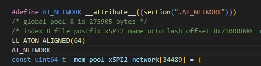

then, in your C Code, you can define this pragma:
#define AI_NETWORK __attribute__((section(".AI_NETWORK")))
and in your network file in AppliAIAppnetwork_atonbuf.xSPI2.c, add the corresponding pragma to your weights allocation:
For more information, you can refer to the LD documentation here, especially the Memory Layout section:
Using LD, the GNU linker - Command Language
If you want to put your weights in the same section as "ROM", you can integrate your C file as-is. No modification needed. However, your ROM should have enough space in order to compile and not have an overflow.
