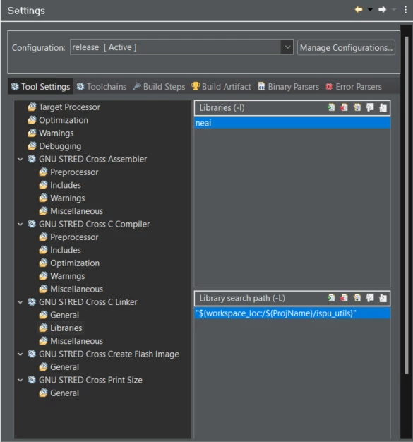

I have generated an n-Class Classification static library with NanoEdge AI Studio using data from ISM330ISN. I want to use this library in the ISPU template project that comes with X-CUBE-ISPU (X-CUBE-ISPU\1.1.0\Ispu\ism330is_lsm6dso16is\template\ispu). I have pasted the .h files (NanoEdgeAI.h and knowledge.h) and the static library (libneai.a) in the ispu_utils folder and have linked the static library by going to Properties > C/C++ Build > Settings > Tool Settings > GNU STRED Cross C Linker > Libraries and inserting the following information:
But after hitting "Apply", "Rebuild Index" and "Apply and Close", when I try to build the project, I get the following errors:

Best answer by LVALV.1
it seems that you did not select the ISM330ISN as the project's target.
You can follow this documentation to start a project for the ISPU : https://wiki.st.com/stm32mcu/wiki/AI:NanoEdge_AI_Anomaly_Detection_library_for_ISPU#Getting_Started
Don't hesitate if you have other troubles creating your project.
Have a nice day
