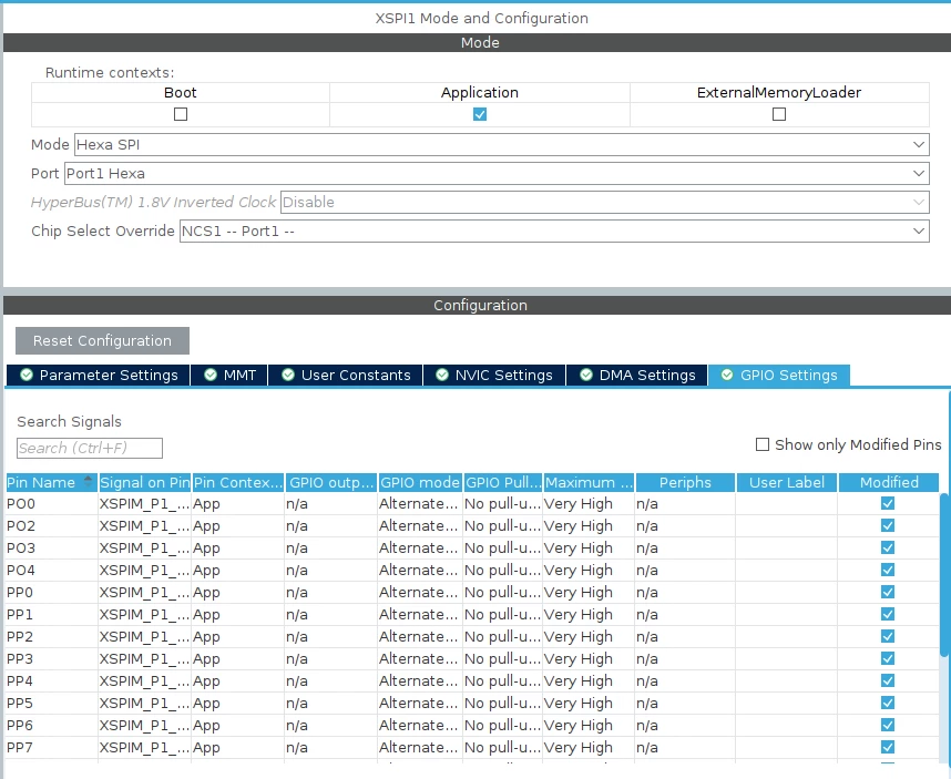

Sep 4, 2024 9:53 AM UTC
Thank you for the reply.

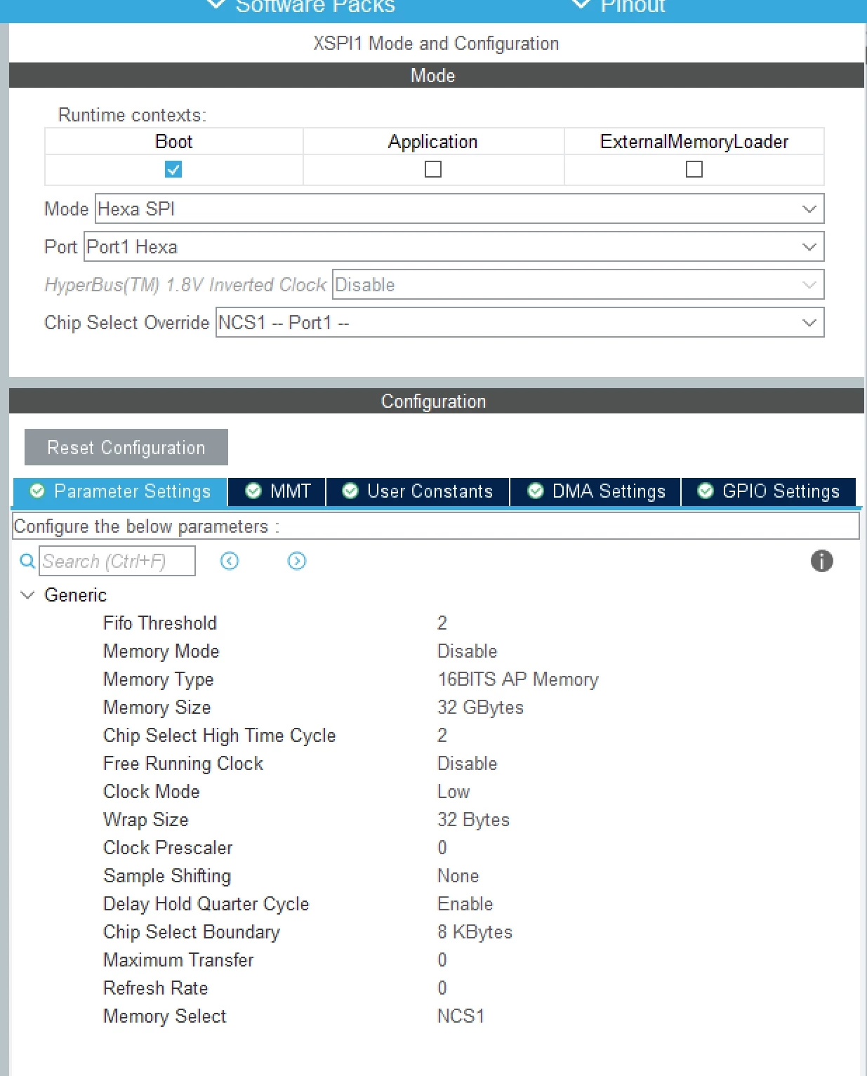

while configuring PSRAM from X-CUBE-AI directly, i need to enable XSPI1 interface, but while running the code i'm getting error "HAL_TIMEOUT" in function "HAL_XSPI_Init".
attaching the SS of XSPI1 config.
Please guide us on the same.
Thanks and regards,
Ishan

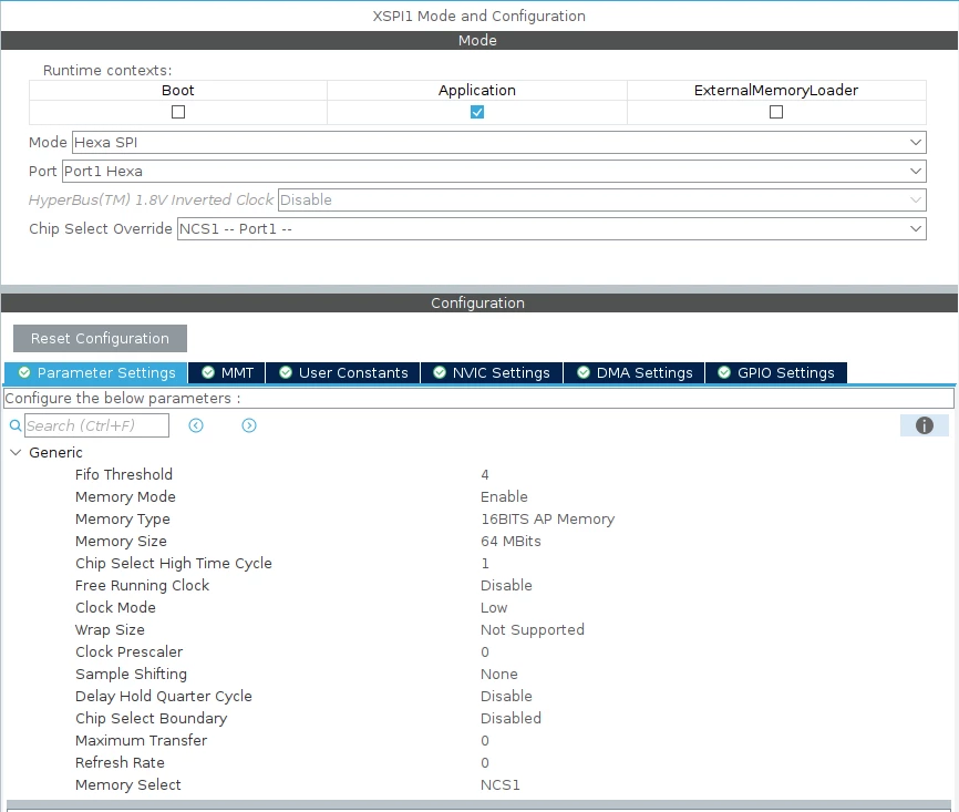

hamitiya
Sep 4, 2024 11:27 AM UTC
You are right, you need to enable XSPI1 but X-CUBE-AI should set the parameters for you.
Could you please try these settings ?
You could also generate a project with ST Edge AI Developer Cloud, it sets all the parameters for you (enabling External RAM and External Flash)
Best regards,
Yanis
EDIT: it looks like you are settings parameters in Application context and not Boot. STM32H7S78-DK is quite low on internal flash, thus, in X-CUBE-AI, we generate a project which "run in place" (see in STM32H7S78-DK the template XIP). This allows you to run directly in External Flash.
​In order to give better visibility on the answered topics, please click on 'Best answer' on the reply which solved your issue or answered your question.

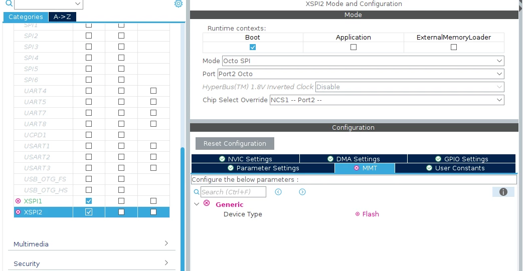

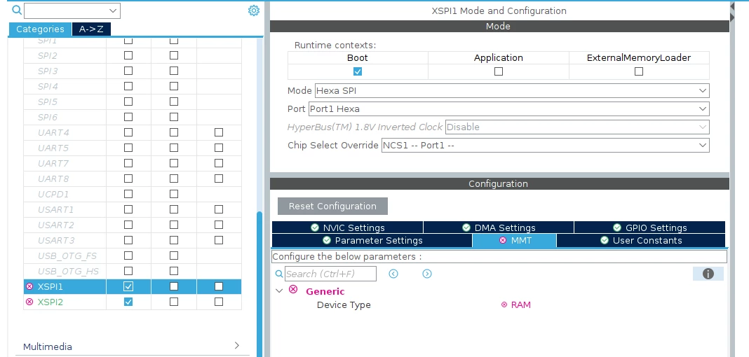

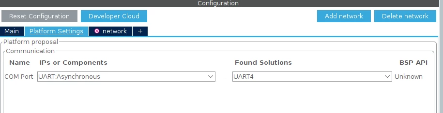

Sep 5, 2024 1:10 PM UTC
I have properly configured and download a project, with configured AI_model and external RAM, from ST Edge AI Developer Cloud.
I took this project as reference and tried same configuration in my project. Still getting three issues, not able to make same configuration as reference project.
1) XSPI1/XSPI2 >> MMT >> Generic >> Device type (Not defined)
Note: If i remove EXTMEM_MANAGER and EXTMEM_LOADER, it's getting (RAM/FLASH), but once i configured EXTMEM_MANAGER and EXTMEM_LOADER, Generic option turns into pink color. and getting below error.
  - Main Config: These peripherals still have some not configured or wrong parameter values: [XSPI1, XSPI2]

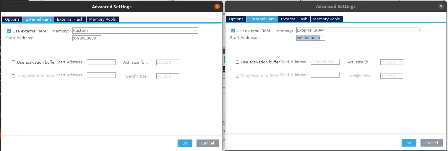

2) In X-CUBE-AI, when i configure External Ram and External Flash, Memory option has only one option "custom". not getting options like, External SRAM or External NOR Flash.
3) How can i add platform Settings in X-CUBE-AL configuration ?
Please guide me on the same, how can i configure it properly.
Thanks and regards,
Ishan.

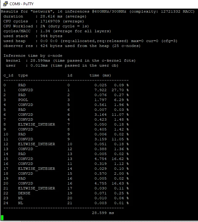

hamitiya
Sep 6, 2024 11:52 AM UTC
Here you will find a template using a model from ST Edge AI Model Zoo.
You can then open STM32CubeMX and replace the model.
It should compile on your side without warning and should output in COM port:
Best regards,
Yanis
