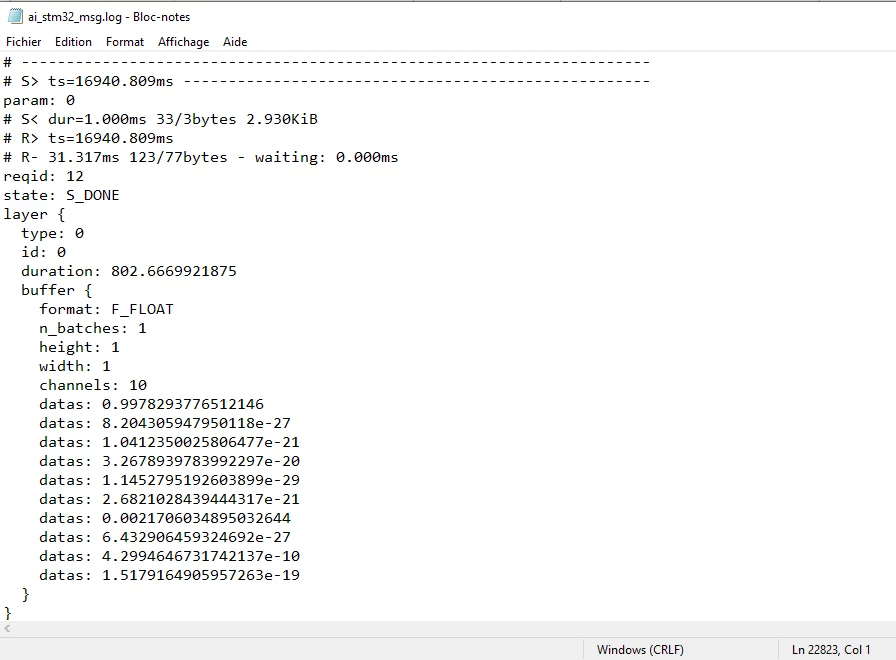

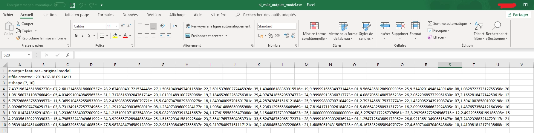

all I can see in the ai_outputs_model.csv and the ai_stm32_msg.log is this :
PS: i used a custom data for cat pictures

Hi @OGaie​ ,
Great! the ai_outputs_models.csv is the file you should be looking at.
In your spreadsheet, you can see you have 7 rows and 10 columns. Each row correspond to the output of an inference. I'm guessing that the last layer of your classifier model is a SoftMax activation function, in that case, you are getting the probability distribution of your 10 classes.
E.g., for the first row:
7.43e-07, 2.60e-28, ..., 9.99e-01, ..., 1.08e-20 -> index n#6 has the highest value (0.999). The first prediction output is a "6 - frog".
Best regards,
Guillaume
