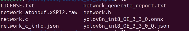

i convert my tflite of yolov8n without nms to neural-art related files in STM32N6 using stedgeai cli command as below

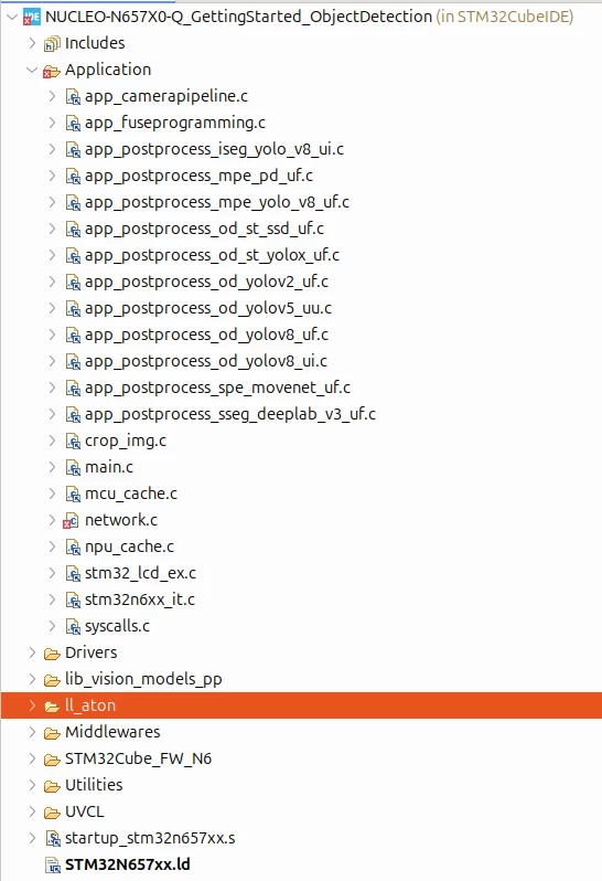

after that, i have to apply it to cubeISE which import NUCLEO-N657X0-Q object detection example.
i have a below question to be answered from you.
1. what is ll_aton? which looks like a runtime such as cuda runtime for nvidia gpu. any link for detailed?
2. please describe the overall on how to apply my weight with fine tunning from yolov8n to STM32N6 neural-art.

1. The ll_aton library is related to the use of the NPU on the N6. So yes, I think your comparison is right.
You can find documentation about it here: https://stedgeai-dc.st.com/assets/embedded-docs/stneuralart_programming_model.html
2. I think the first document I linked should answer your question. You first retrain your model on your usecase, then quantize it, use the st edge ai core to convert it to a C model and build your application around it (camera pipeline, preprocessing, postprocessing and display if you need).
