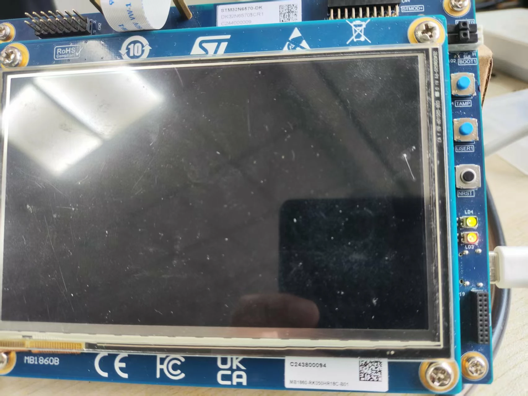

Help, stm32N6 fails to use st-mnist, no response.

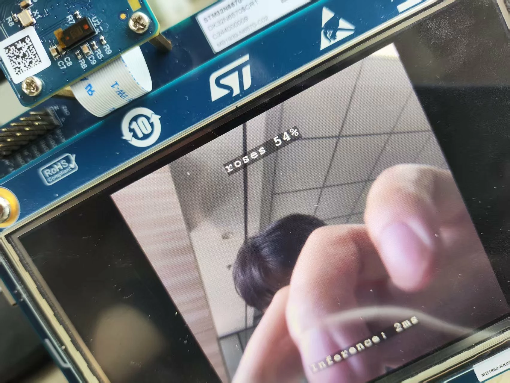

Please help, why can my configuration of flower work normally, but when I change the model st-minst and follow the same steps to deploy and burn, the LCD screen does not light up and the model does not work.

Hello, I use st-minst in ST Model Zoo to deploy my project, but when I burned stm32N6570_DK, it didn't work. However, I tried flower and food and they both worked fine. Why can't st-minst work? Are there other steps required?
This is my command and .yaml content
python stm32ai_main.py --config-path ./src/config_file_examples/ --config-name deployment_n6_config.yaml

Julian E.
May 23, 2025 8:44 AM UTC
Hello @LQC_ ,
The Mnist model was trained using grayscale images but the deployment on N6 does not support mnist so I would not advise you to use it.
That being said, I could not reproduce your issue.
  • Are you using a usb C to usb C cable? In some case, you can have issues because of the power supply.
  • Did you unplug/plug again the board after switching the pins to the left?
  • Do you get any errors during the deployment?
You cubeIDE path is very strange, maybe it comes from that.
You may try to create a new clean install of model zoo.
I attached my exact yaml for reference.
Have a good day,
Julian
