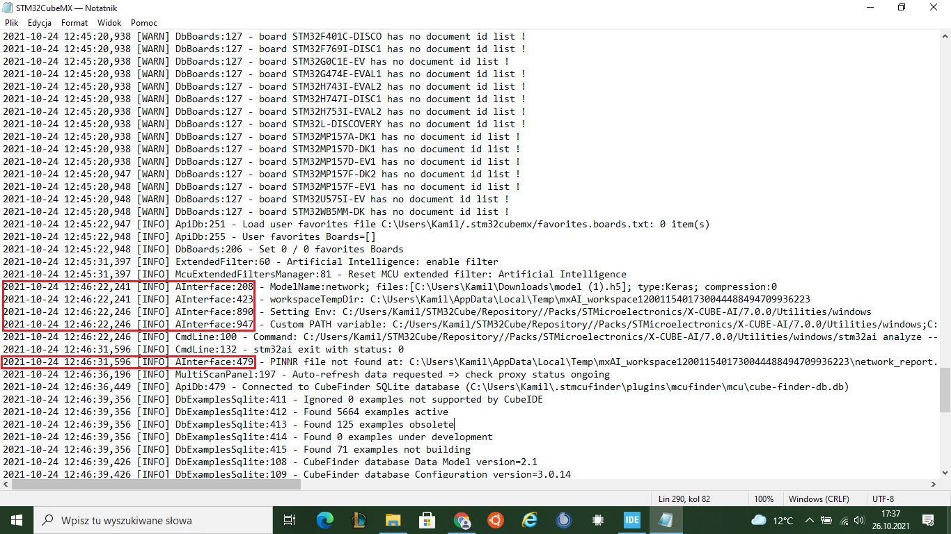

Thank for your answer, I checked logs in the file you mentioned, but I don't know what it mean. I put this file in an attachment and I marked lines connected with AI on the additional screen. Maybe it tells you something and you can tell me where the problem is.0693W00000FDoRcQAL.png

The "interesting part" is this one
2021-10-24 12:46:22,246 [INFO] CmdLine:100 - Command: C:/Users/Kamil/STM32Cube/Repository//Packs/STMicroelectronics/X-CUBE-AI/7.0.0/Utilities/windows/stm32ai analyze --name network -m C:/Users/Kamil/Downloads/model (1).h5 --type keras --compression 1 --verbosity 1 --workspace C:\Users\Kamil\AppData\Local\Temp\mxAI_workspace1200115401730044488494709936223 --output C:\Users\Kamil\.stm32cubemx
2021-10-24 12:46:31,596 [INFO] CmdLine:132 - stm32ai exit with status: 0
On your machine stm32ai command line seems to have execution problems
Can you first rename your model to remove the (1) and the spaces
Then can you try to open a command line and then enter the following commands
cd C:\Users\Kamil\STM32Cube\Repository\Packs\STMicroelectronics\X-CUBE-AI\7.0.0\Utilities\windows
set _DEBUG=1
stm32ai analyze -m C:\Users\Kamil\Downloads\model.h5
Maybe with more debug information we'll know where the problem is
Regards
Daniel
​In order to give better visibility on the answered topics, please click on 'Accept as Solution' on the reply which solved your issue or answered your question.

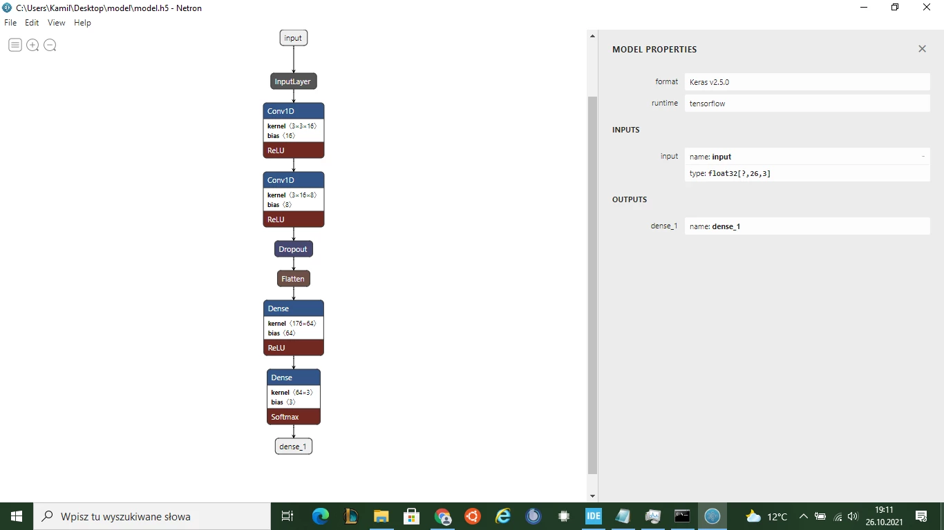

Also you can verify with a tool like Neutron that your h5 is a regular Keras file
HWorl.1
HWorl.1Author
October 26, 2021
I verified the model in Neutron with the result as in the appendix. Looks like a Keras model. Additionally, I put the result from Neutron and from command line.0693W00000FDp0OQAT.png
