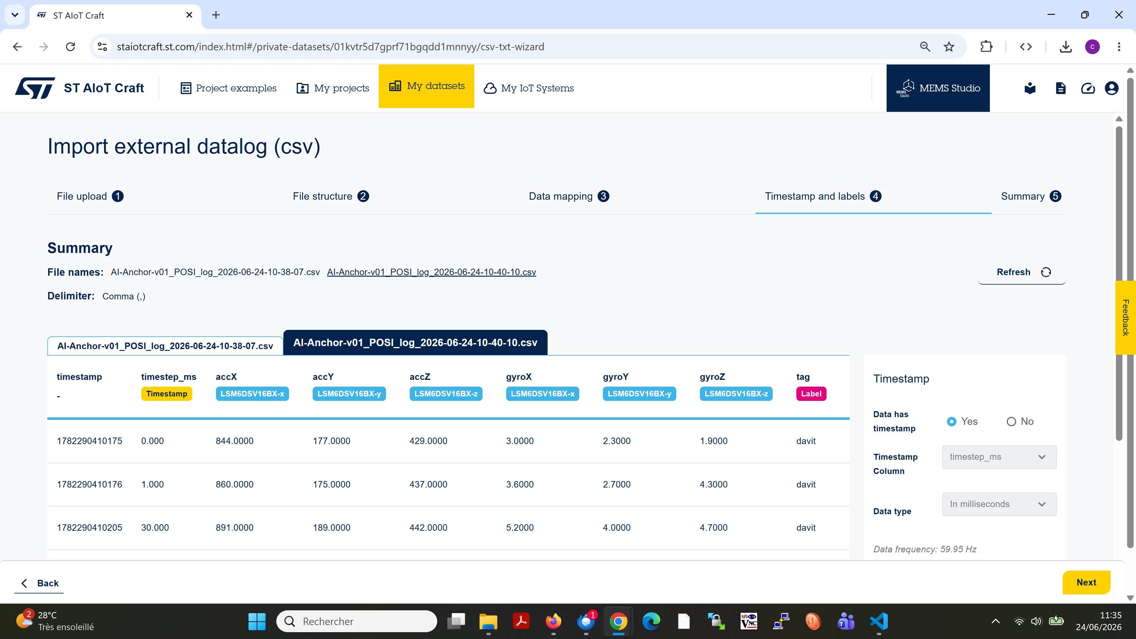

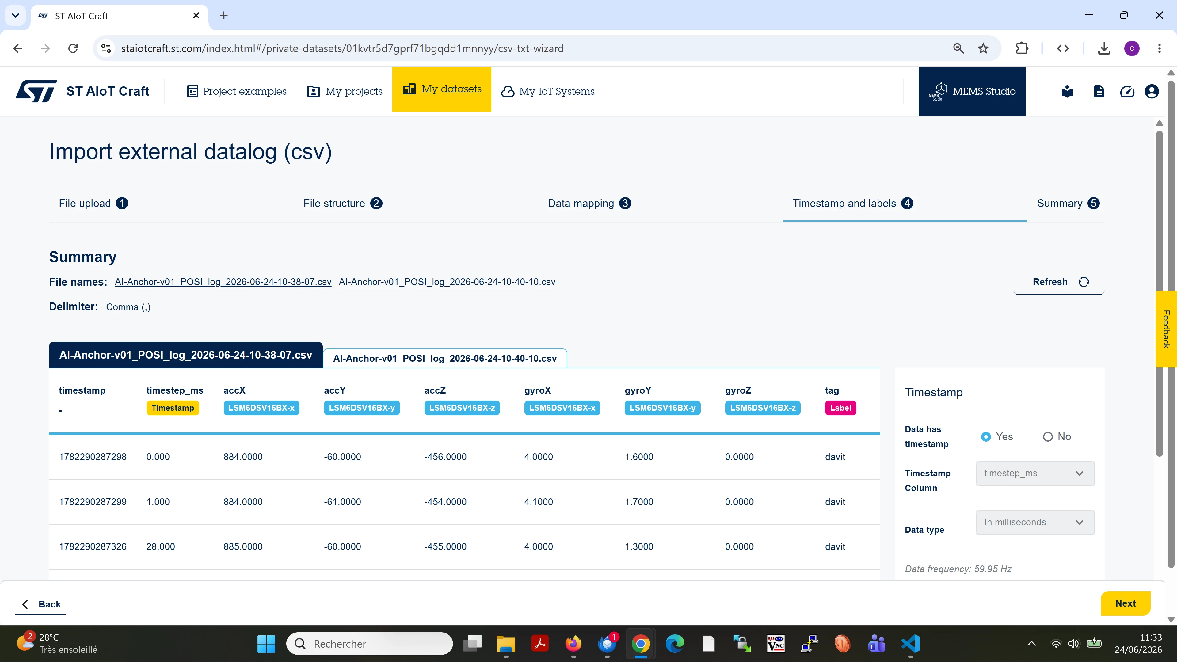

Hello team,
i thing there is a bug in ST AIoT Craft when loading multiple .csv dataset files.
With figures, you can see respectively :
  • 2 .csv files
  • 3 colums for accelero and 3 colums for gyro
  • 1 for time_step
  • and the last one for tag with 6 different values
The 1st and 2nd images show clearly the 2 files correctly tagged.

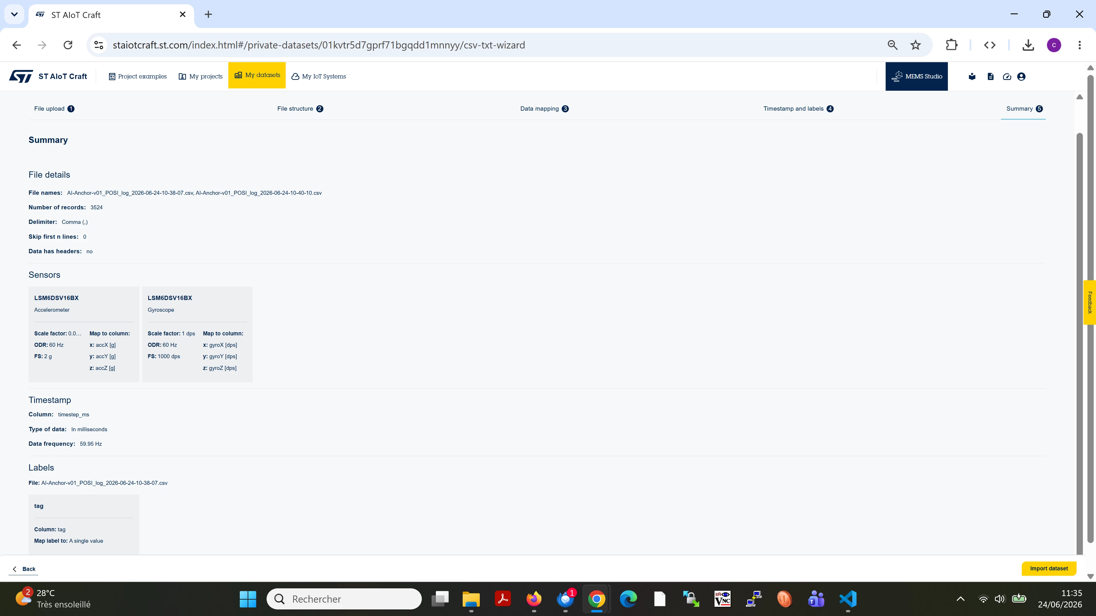

The 3rd image show the Summary and if you zoom in section Labels, tou can note that only 1 file (and not 2) is concerned with tag.

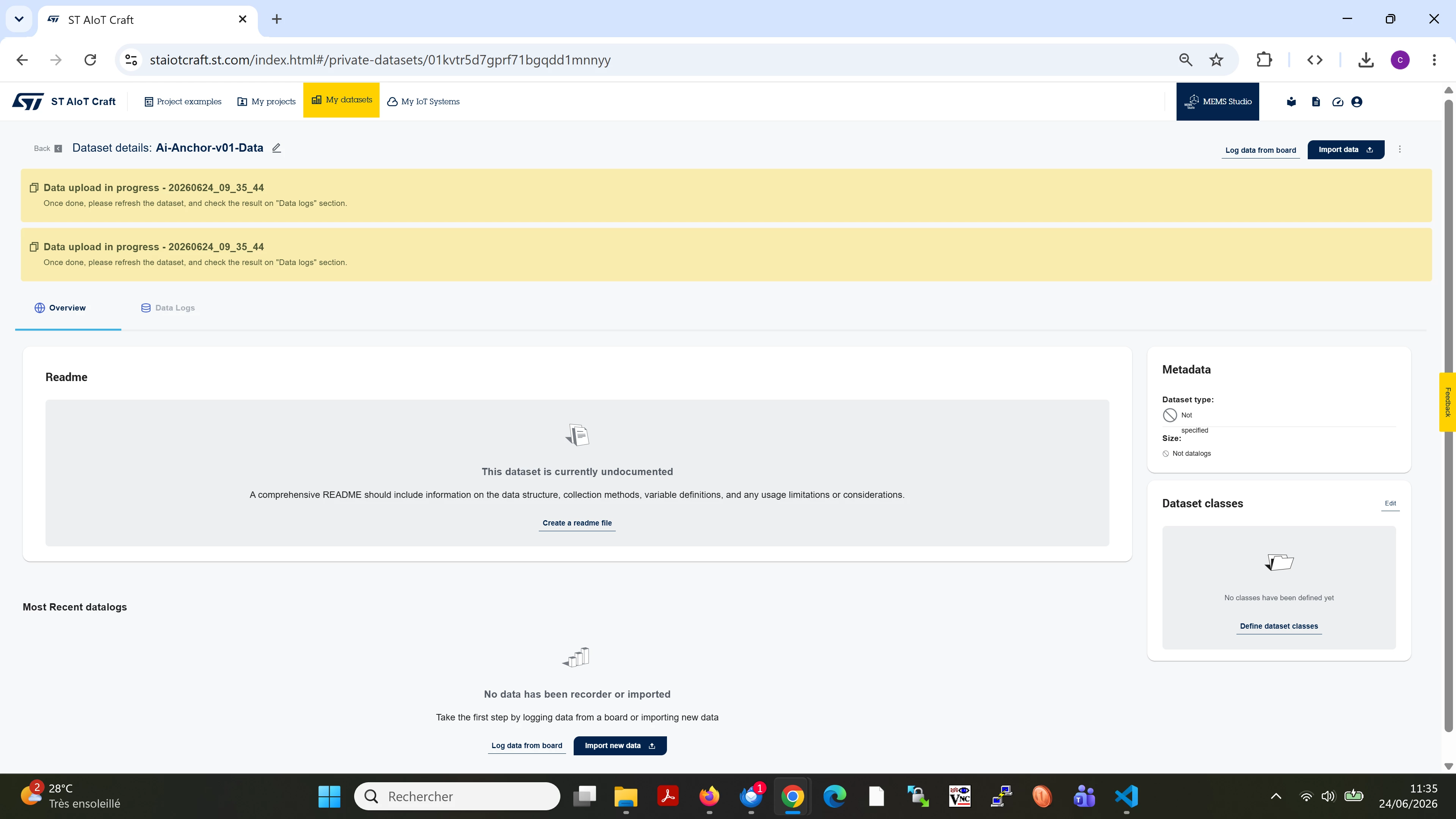

Import is done in image 4 with the 2 .csv files.

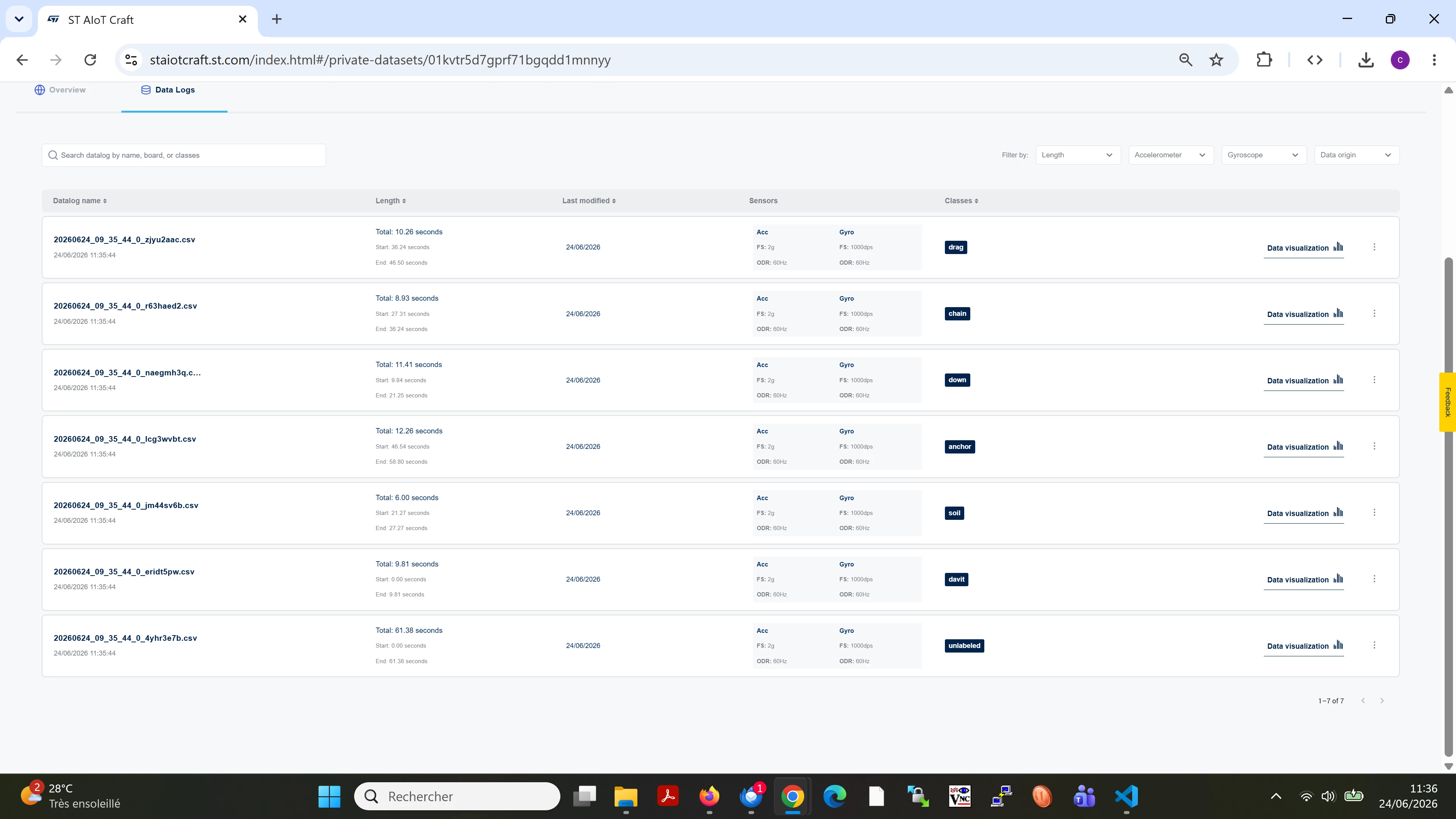

And last image indicates that the last datalog is completely “unlabeled”. This dataset correspond to the missing “Labels Tag” file, that is “xxx10-40-10xx”
So i concluded that the “tag” process for multiple .csv file is “not clear”.
Error is already visible in image 3.
