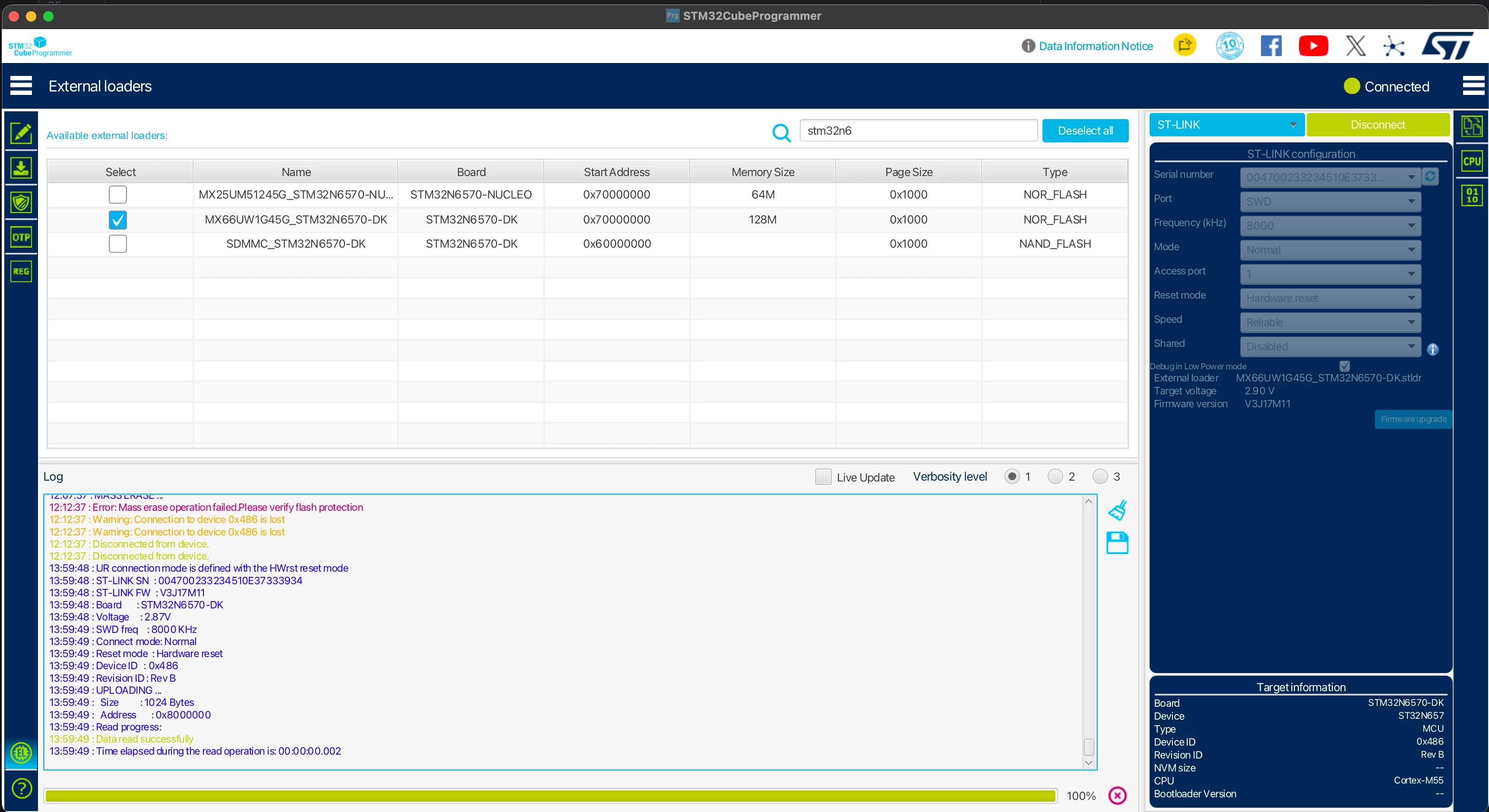

Hi all,
I’m trying to follow this guide here but when I try to run the model on target I always got an error
failed to erase memory.Here is the log. I’ve also set external loader from cubeprogrammer to MX66, and if I try to erase memory from cube programmer I also have an error, loose comunication with the board

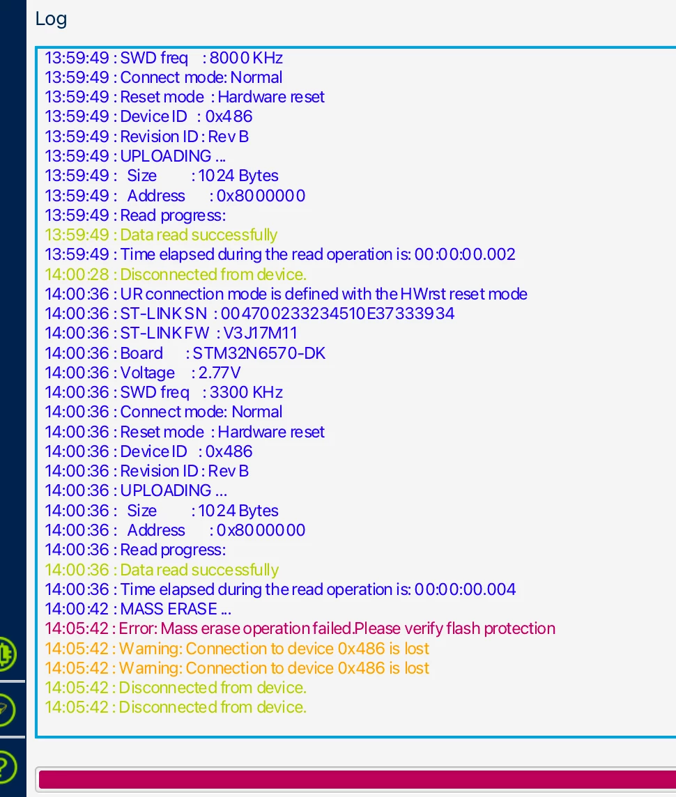

Hi ​@SBaro.11,
There is no reason that would make you unable to use the board.
  • Make sure to connect the board via the ST link, not the other USB.
  • You need to put both boot pins to the right (near the edge of the board)
    (if you do it plugged, you need to do a power reset)
  • Use a USB C to USB C cable with data, this could be a voltage issue.
  • Make sure to update CubeMX. There was an issue with the N6firmware package 1.4.0
    Normally this should not have an impact, but you may use another version.
In your logs is written “2.77V” which seems very low, we should have 3.3V. The voltage seems to be an issue.
Is your led on the right side of the board green or orange (the bottom one). This should be green.
Have a good day,
Julian

Sep 4, 2026 10:51 AM UTC
It looks like the issue may be related to the external flash or loader configuration, especially since CubeProgrammer also loses communication during the erase. Have you tried lowering the SWD frequency and testing the MX66 external loader separately?

Yes I’ve set the external loader as you can see here :
I did a test with 3300KHz frequency setting I have the same issue with cubeprogrammer trying to Full chip erase here is Log output (0x7000000)

I just tried reducing the frequency to 50kHz; I managed to erase the first sector, but if I try to erase multiple sectors, I run into the same problem. Even if I drop it to the lowest setting—5 kHz—I still have the same issue. As it stands, I can't use my board.
