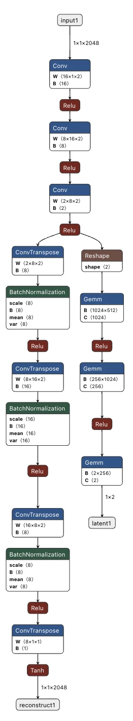

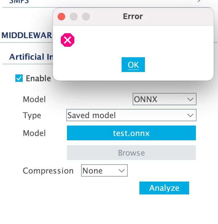

Hi, Thanks for your attention. I am analyzing the .onnx format model but an error occurs. I try to reinstall the stm32cubeMX but it doesn't help.
0693W00000QKl99QAD.pngThe part of architecture is:
Here is the log information. Can you help me with this problem? @Romain LE DONGE​  @jean-michel.d​ @fauvarque.daniel​  Thanks very much!

I have checked that all the layers in my .onnx model are supported.
Please refer to ..../STM32Cube/Repository/Packs/STMicroelectronics/X-CUBE-AI/7.2.0/Documentation/supported_ops_onnx.html
fauvarque.daniel
July 8, 2022
Do you have the same error when running the stm32ai command by hand in a terminal window ?
just type
/Users/name/STM32Cube/Repository//Packs/STMicroelectronics/X-CUBE-AI/7.2.0/Utilities/mac/stm32ai analyze /Users/name/STM32Cube/test.onnx
Regards
Daniel
​In order to give better visibility on the answered topics, please click on 'Accept as Solution' on the reply which solved your issue or answered your question.
BHuan.3
BHuan.3Author
July 8, 2022
Dear fauvarque.daniel @fauvarque.daniel​ ,
Thanks for your quick reply. I try the follow exec command but get the error: illegal hardware instruction. I am using an M1 pro chip in Macbook pro 14inch.
There is the same question unsolved here.
https://community.st.com/s/question/0D53W00001dwl1GSAQ/stm32ai-illegal-hardware-instruction-on-mac-m1
Looking forward to your reply.
fauvarque.daniel
July 11, 2022
The current generation for Mac is done for x86 based mac assuming that Apple has implemented a backward compatibility with the x86 applications.
It doesn't seem to be the case, we'll have to investigate how to solve the issue (specific build for the M1 ?)
Regards
Daniel
