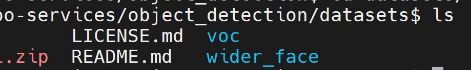

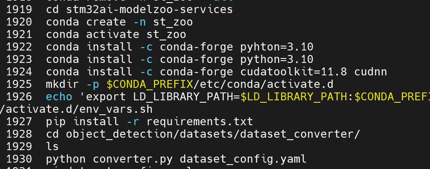

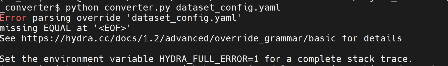

I'm using ubuntu environment. After installing the conda environmen environment according to the wiki, I used the same dataset and path, and reported an error after running converter.py, as shown in the figure below. How to solve it?
You can reproduce the problem after pip install -r requirements.txt and run python converter.py dataset_config.yaml.

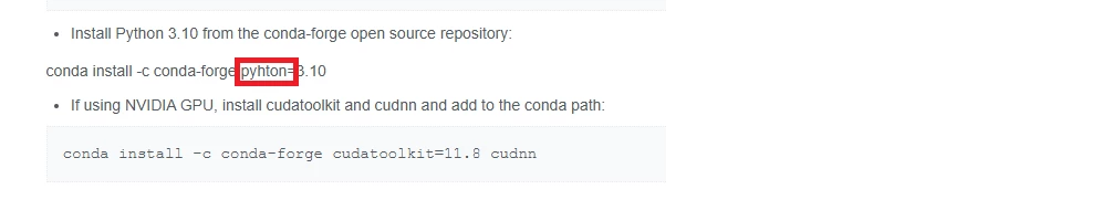

I found a typo, python is not pyhton.
