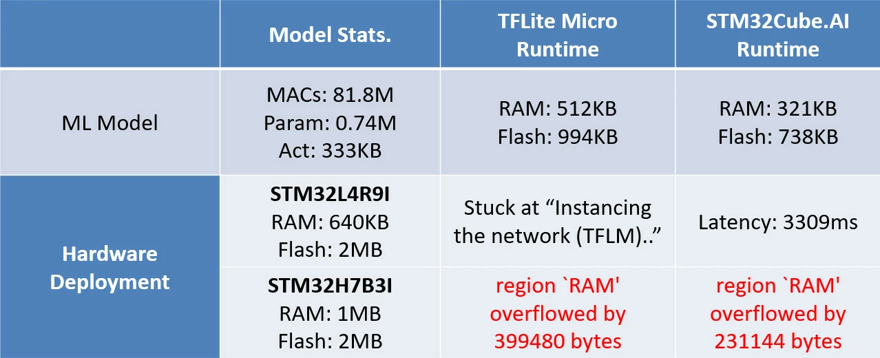

Hello everyone,
I am trying to deploy ML model to microcontrollers and I have two boards of STM32L4R9I-Discovery​ and STM32H7B3I-Discovery. The experiments and related results are shown below:
0693W00000Czv2EQAR.jpgI use TFLite Micro and STM32Cube.AI runtime to profile my ML model and then compile on two different boards. The hardware resource related to these two boards are provided and STM32H7B3I is a bigger one. However, it's strange that I can successively get the results on smaller board (STM32L4R9I) but build fail on a bigger one (STM32H7B3I) with the following error:
.../arm-none-eabi/bin/ld.exe: *****.elf section `.bss' will not fit in region `RAM'
​.../arm-none-eabi/bin/ld.exe: region `RAM' overflowed by 251112 bytes
Could anyone provide some suggestions about how to address this issue? Thank you very much.

Thank you very much for your reply. I am a novice of microcontrollers. Based on your suggestion, I have checked "STM32H7B3LIHXQ_RAM.ld" and found the following information:
MEMORY
 RAM_EXEC (xrw) : ORIGIN = 0x24000000, LENGTH = 1024K
 RAM (xrw)   : ORIGIN = 0x20000000, LENGTH = 128K
 AHB_SRAM (xrw) : ORIGIN = 0x30000000, LENGTH = 128K
The part of RAM is actually not enough. Based on the reference manual, SRAM1-3 have 256KB, 384KB and 384KB, respectively, and I guess it is the part of RAM_EXEC. And I have also checked "STM32H7B3I_ST_MCU2.map" and got the following information:
Memory Configuration
Name       Origin       Length       Attributes
FLASH      0x08000000     0x00200000     xr
RAM       0x20000000     0x00020000     xrw
AXI_SRAM     0x24000000     0x00100000     xrw
AHB_SRAM     0x30000000     0x00020000     xrw
*default*    0x00000000     0xffffffff
It is strange that the name of RAM_EXEC is changed to AXI_SRAM. I have tried to increase the length of RAM in "STM32H7B3LIHXQ_RAM.ld" and then built again, but the length of RAM in "STM32H7B3I_ST_MCU2.map" doesn't change.
Could you provide more information about how to address this issue? I also attach these two files as references. Thank you very much!
