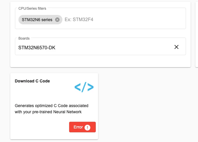

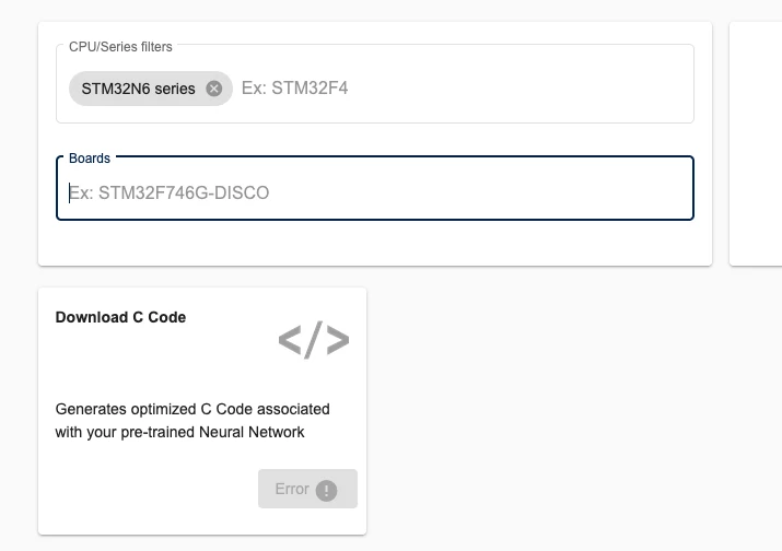

Hi @francovaro,
This is indeed the case. it seems to be a bug for now.
So how to work in the meantime? it depends on your target:
Non NPU target:
We advise that until March, for "normal" stm32, you use the version 2.2 of the core (so X cube AI 10.2 and you should also be able to use it in the dev cloud). This is because the new 3.0 version is mainly a NPU improvement.
For NPU target (your case):
CubeMX do not really support the N6 correctly, so everything is available directly in the ST Edge AI Core install folder. Which means that you can use the 3.0
The validation application is in C:\ST\STEdgeAI\3.0\Projects\STM32N6570-DK\Applications\NPU_Validation
Here is a guide on how to use it, for more details please visit: https://stedgeai-dc.st.com/assets/embedded-docs/stneuralart_getting_started.html

Jan 14, 2026 11:42 AM UTC
Yes it's fixed!
thank you
