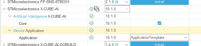

deploy ai model on the STM32H743
I want to deploy an ai custom model on the STM32H743. Are there any relevant tutorials or examples?

Hi @llcc,
For STM32H743, the process to deploy a model is standard, so it is not as difficult as for the N6.
The only thing to do is to download the latest version of X Cube AI in CubeMX.
Then create a project, activate X Cube AI, select the application template.
Browse for your model in the X Cube AI interface, run a analyze to make sure that your model is being compiled correctly, then generate the code with cubeMX and that's it.

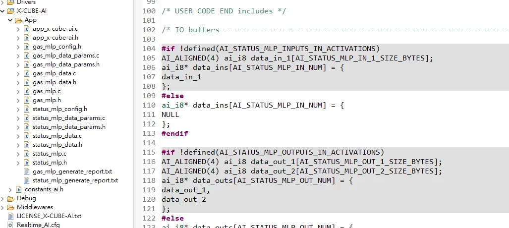

Hi, Does the model deployed on the STM32H743 need to be quantized first like the n6, or can floating-point types be deployed directly? Additionally: After the deployment is completed, how should I pass the data to the model for inference and obtain the inference results? If using serial communication for data transmission, do I need to additionally configure the serial port and clock in CubeMX? Is there example code for specifically passing input samples via serial communication? Thanks!
Oct 23, 2025 8:26 AM UTC
HI , llcc
Please check settings , some variables are not automatically generated , like IO buffers variables

Oct 23, 2025 8:39 AM UTC
Thank you! The problem has been resolved; it appears to have been an issue with the clock configuration.
