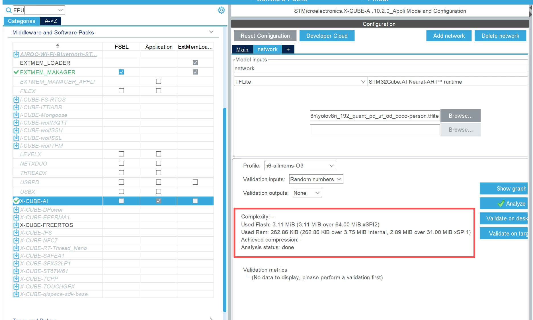

Dear ST staff, Recently, while using STM32CubeMX with CubeAI to deploy the yolov8n_192_quant_pc_uf_od_coco-person.tflite model from object_detection onto the STM32N6570-DK development board.
        Subsequently, following CubeAI's configuration, I programmed the network_atonbuf.xSPI2.bin file into the 0x71000000 memory location
It is worth noting that this model is of type float, not int8 quantisation (as I understand it), and both member pointers in
LL_Buffer_InfoTypeDef's
const float *scale; /**< */
const int16_t *offset;
are NULL. This should indicate that the output requires no normalisation conversion.

Hi @实在太懒于是不想取名,
First of all, the model is quantized in int8, it is just that the input and output are float32 (converted to or from).
Then in your case, I think you should compare the C model output and the original tflite output.
To do so, in a first step, you should use the "validation on target" from X Cube AI or do it manually:
https://stedgeai-dc.st.com/documentation
You want to look at the COS, if close to 1 then at least your output the one expected.
Then, maybe you don't print them correctly. To know that I suggest you use the AI Runner to get the output of the C model and compare them to the tflite model
Documentation: https://stedgeai-dc.st.com/assets/embedded-docs/ai_runner_python_module.html
The AI runner can be found here: \ST\STEdgeAI\2.2\scripts\ai_runner

Dec 5, 2025 1:36 AM UTC
Thank you for your reply. I believe I have identified the root cause of the issue: I had not configured the NPU option in RIF. After enabling it, all outputs now fall between 0 and 1.
