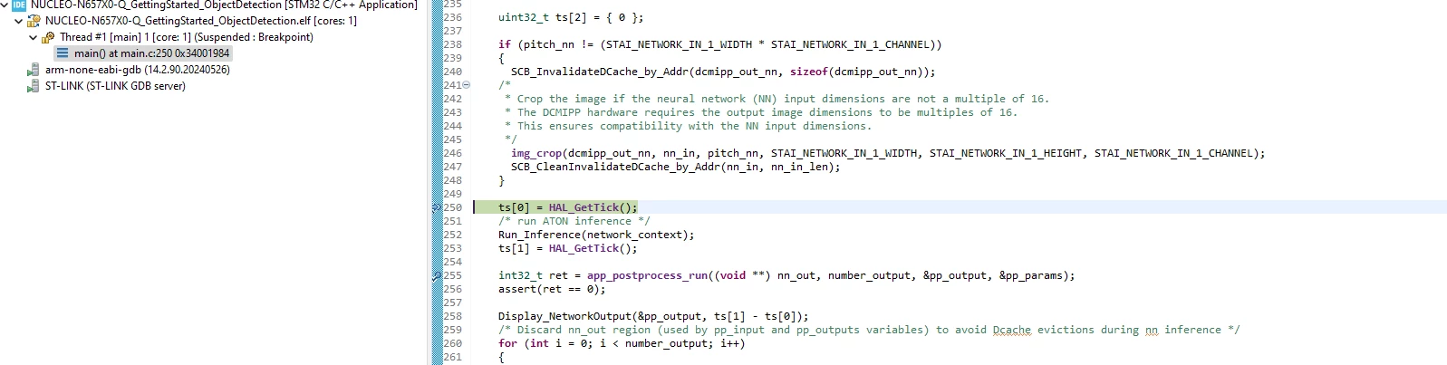

To give you precisions, the compilation / toolchain does produces the required C files, build application and flash it on the Nucleo board. However, when booting the board in flash configuration I don' get an output on the USB UVCL (I usually wait for about 20 seconds).
When I open the application project via STM32CubeProgrammer, start the board in Development mode and run in Debug; I do see the application launching but when reaching Run_Inference() the application fall in infinite loop. I usually place a break point before that to take a closer look. It's fine when using modelzoo but with trained mode this struggle.
