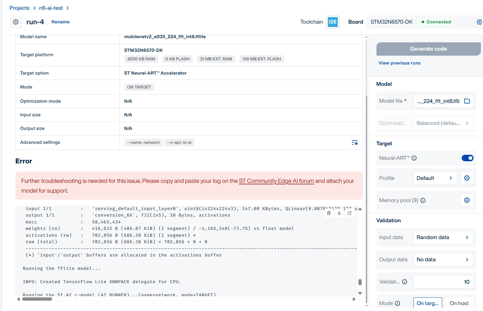

Visitor II
Jul 11, 2026 3:56 AM UTC
@Julian E.
I am facing the similar issue.
my cube ai studio version/cubemx/cubeide  are the latest windows version downloaded yesterday.
hardware is  N6 DK board.  the .tflite file is from model zoo.
It succeed run on host, only failed on target.
but there is no <die id="481">  in my boardExternalMem.xml.
Running the ST.AI c-model (AI RUNNER)...(name=network, mode=TARGET)
E200(ValidationError): TARGET: Unable to bind the ST.AI runtime with "network" c-model: []
 E801(HwIOError): Invalid firmware - COM38:115200
 INFO: Created TensorFlow Lite XNNPACK delegate for CPU.
