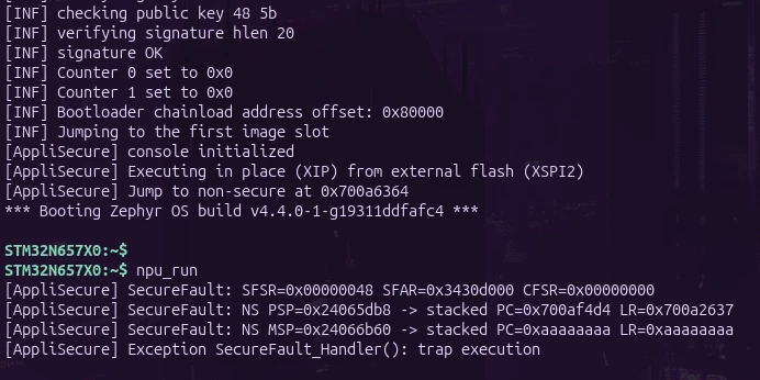

Result:
Secure exception triggered by CPU access to secure memory

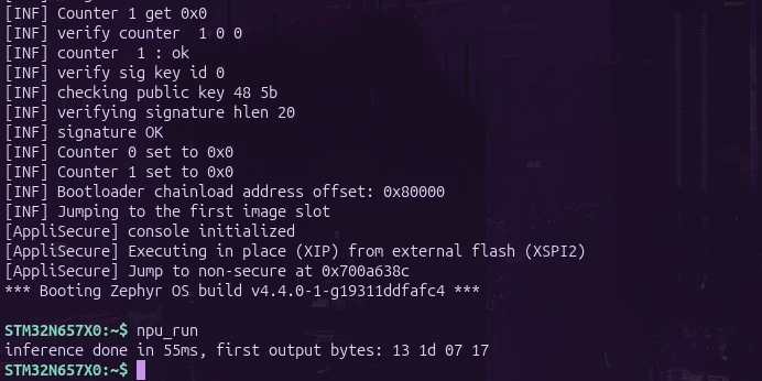

After applying proposed fix the interface is running without issues.
Result after applying mentioned patch
