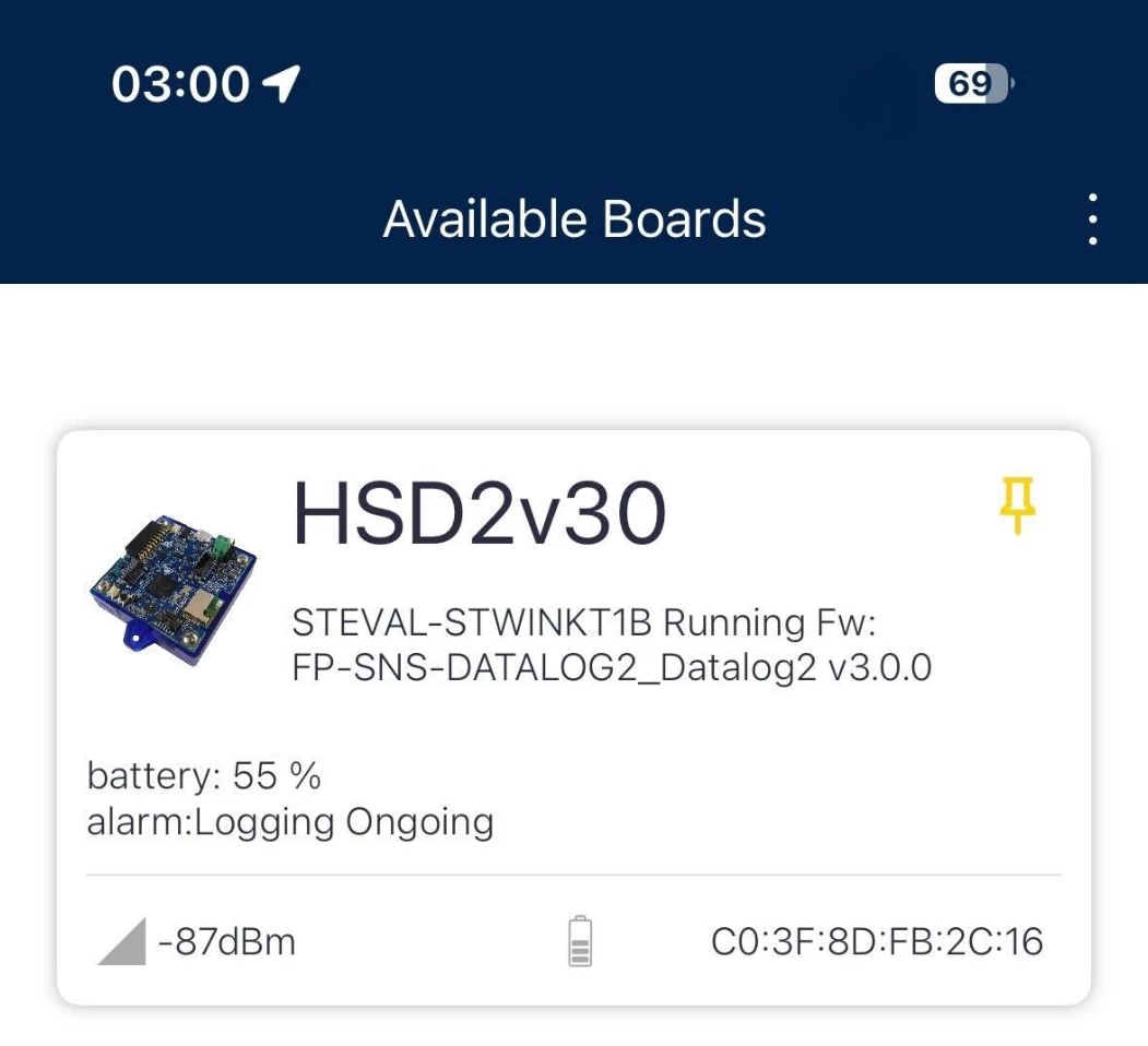

I monitored the logger as much as possible. After 8 hours, the green LED was still blinking, and the ST BLE Sensor app showed:
Alarm: Logging ongoing
Battery: 55%
(see screenshot below)

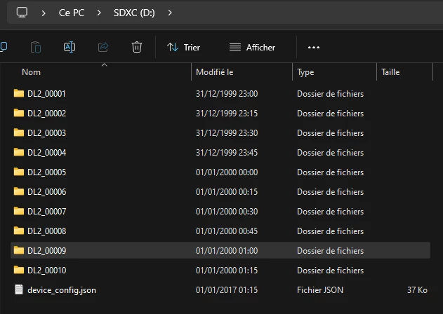

However, when I checked the SD card, I only found about 2.5 hours of data, specifically, 10 folders of 15 minutes each. But I expected at least 8 hours of logging.
So my question is: Why do I only get a few hours of logged data, even though the logger appears to be active (green LED blinking) for much longer?

I tested different SD cards and power supply setups. I can't find any issue while using an external power supply or a power bank via USB. Instead, I got your same undesired behavior with a couple of SD cards with the board battery-powered.
While acquiring data on the SD card, the firmware checks for the battery status: if it detects something not working properly (battery discharge, low battery percentage, ...), it saves data and closes the acquisition. This is a safety procedure that we implemented to avoid broken data acquisition due to a power supply failing.
My suspect is that there’s an issue in the battery status check: I'm debugging there, wishing providing you with a solution soon.
