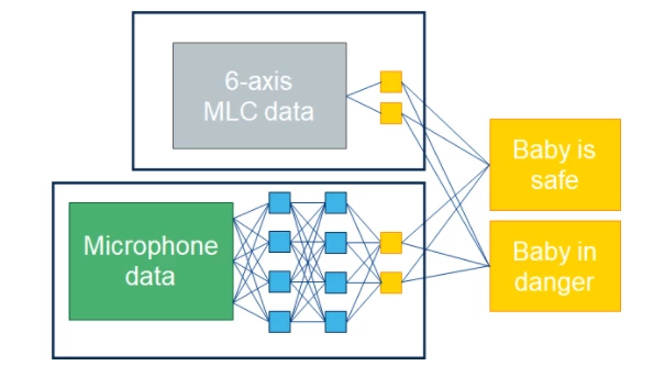

Baby Detector is an application developed to sense the presence of babies in a small environment. The idea is to face the problem of babies forgotten inside cars, that can lead to their death especially on hot summer days.
The core elements of the system are: a MP23ABS1 analog MEMS microphone, able to detect sound made by these babies; a STM32F4 micro-controller able to process the audio data and several different motion/environmental sensors from ST portfolio checking the environment conditions, that can raise the danger for the baby if too harsh.

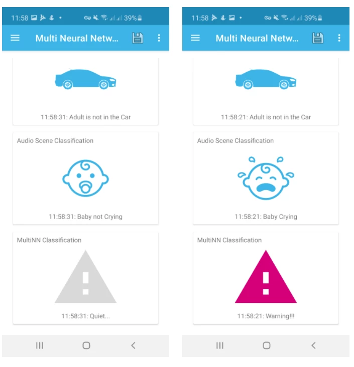

Eleon BORLINI
October 22, 2021
App screen:
