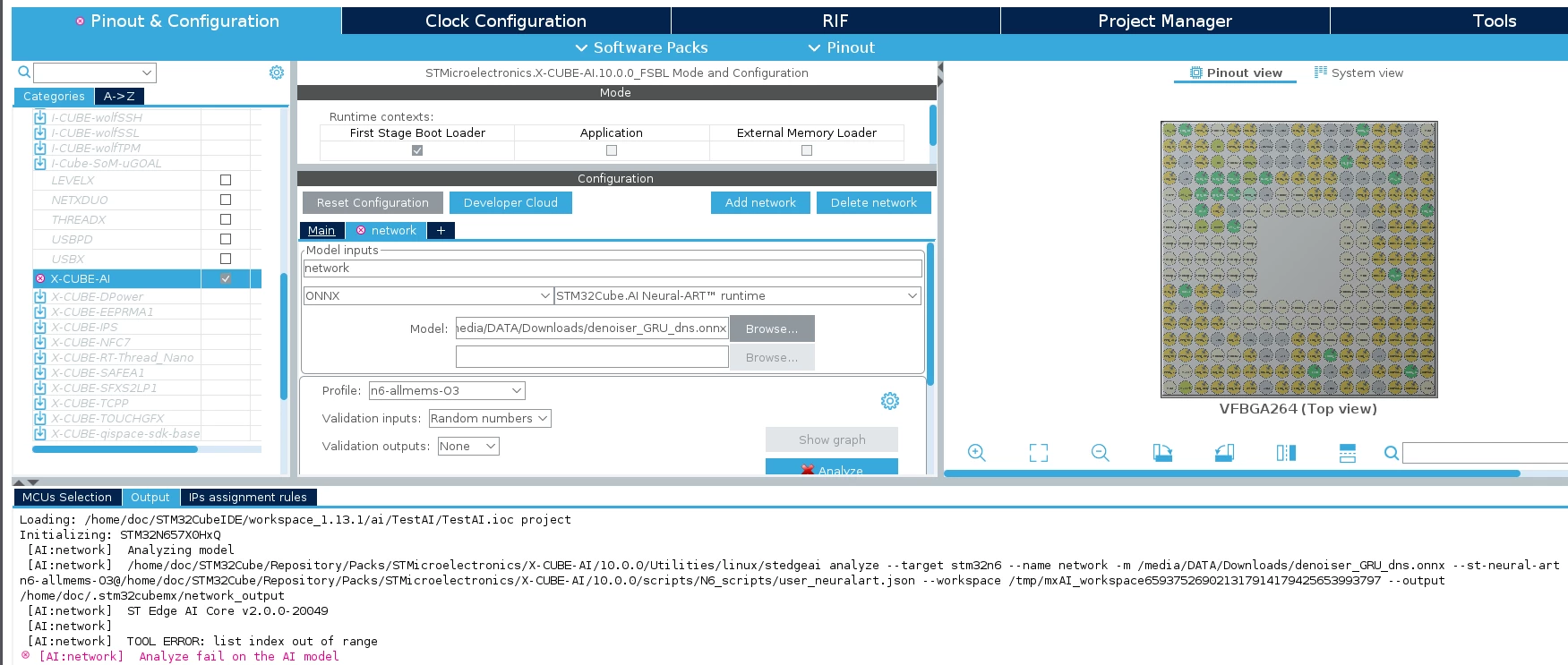

Analysing onnx model error: TOOL ERROR: list index out of range
I'm trying to test a model on the STM32N6 but stedgeai tool fails to analyse the model:
ST Edge AI Core v2.0.0-20049
I'm using X-CUBE-AI 10.0.0, STM32CubeN6 v1.1.0 and STM32CubeIDE 1.18.0.
The model I'm trying to use is in attachment.
I've also tried with STM32Cube.AI MCU Runtime mode but the error is the same.
How can I fix the issue ?

Hello @AMurz.1,
Sorry for the late answer.
I have tried multiple things, but I could not solve your issue.
For sure, the GRUs layers are the cause of the error but it is a stedgeai core bug.
GRUs and LSTMs are badly supported as of today.
Here are steps that I followed, if it can help you for future work:
  • You can expend the log error by first using: export _DEBUG=2 in a git bash before the stedgeai generate
  • Fixing the batchsize to 1 generally helps
  • use onnx shape_inference to make sure all shape are correct (or just to have them all in the neutron plot)
  • you try to use onnx simplifier (onnx-simplifier · PyPI)

AMurz.1
AMurz.1Author
Apr 22, 2025 9:11 PM UTC
Thanks for your reply.
_DEBUG=2 is very useful :)
I've also tried this which further reduce the graph (I think it preprocesses weights data like onnx simplifier does):
from onnxruntime.quantization import preprocess
preprocess.quant_pre_process("denoiser_GRU_dns_nobatchsize.onnx", "denoiser_GRU_dns_nobatchsize_preprocess.onnx")
And I get the same error "ValueError: operands could not be broadcast together with shapes (1024,) (512,) ".
But I see that the previous Transpose node seems to be misinterpreted:
Computing all activation shapes of node_32 (Transpose)
 In shapes [(BATCH: 1, CH: 257, H: 1)] - In values shape [None]
 Resetting shape of node_32
 Computing remapping starting from (2, 0, 1)
 Computed remapping is
 BATCH <- H
 CH <- BATCH
 H <- CH
 BATCH <- H
 CH <- BATCH
 H <- CH
 Found new output shapes: [(BATCH: 1, CH: 257, H: 1)]
The output shape should be [1, 1, 257] instead of [1, 257, 1]:
But the error is the same at the GRU node. Maybe it expects the same dimensions for weights as a LSTM (which expect [num_directions, 4*hidden_size, input_size] for weights), but GRU needs 3*hidden_size instead of 4.
