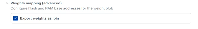

Open “Memory Pools” > “Weights Mapping”

I did find a rather promising documentation shortly after my post. It is “stneuralart_memory_initializers.html”. I think this answers my own complaint about “Or I did not find the proper docs.”.
The unexpected memory allocation may be due to a linker script glitch as described by Mr. Zahimi 6 days ago. The weights probably ended up in rodata by default. I should be able to get that straight in my project.
